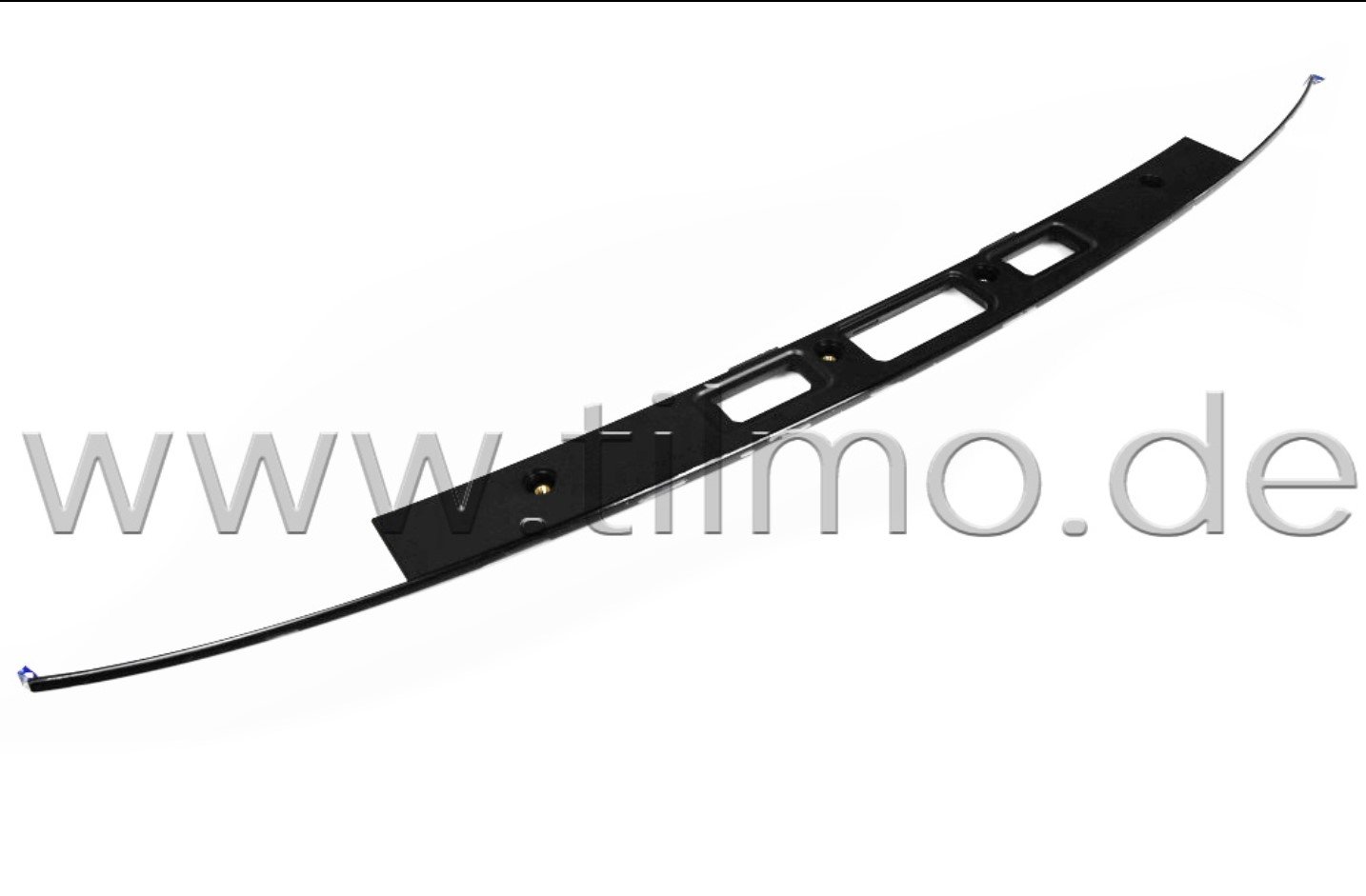

a person who's done the FL tail light upgrade also advises that the RVC and boot open button differs from the current pre-FL Superb.  which is a shame 😞
see pic of centre trim below, showing the holes for the RVC+boot button and the two numberplate lights.

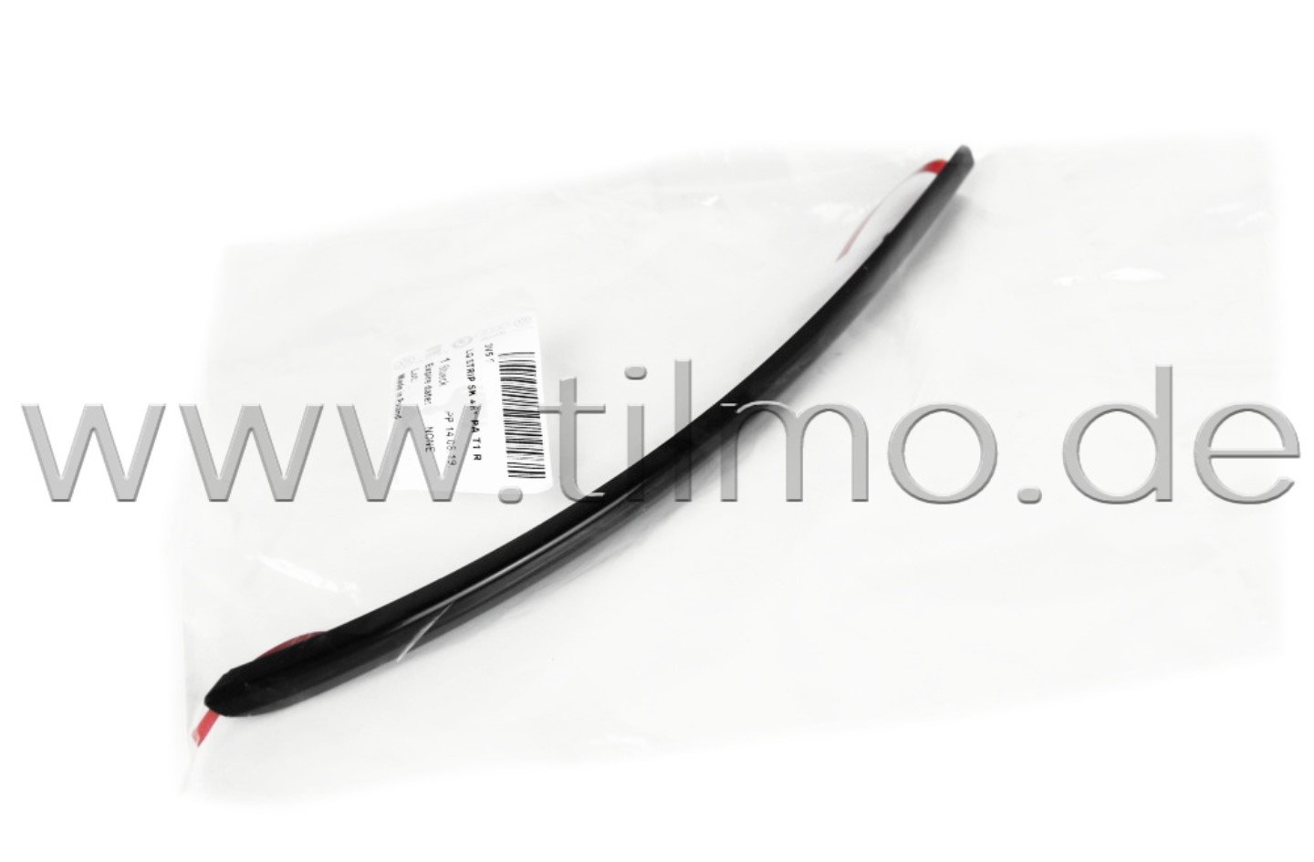

close up pics of the bits n pieces:-
centre trim
19176533_bootchrome-centre01.thumb.jpg.2194344784eb99093480312701002cc6.jpg\
boot bit
