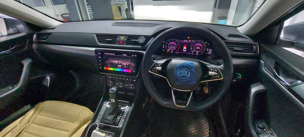

So it’s finally done. Unfortunately I had to get outta country to get it done as I couldn’t find any one competent to do it. Full facelift conversion including matrix headlights, tail lights and self driving options (traffic assist and travel assist)

you got any more details on what was changed in detail and what modifications were made?
also, cost?
Wow - that’s some work there!
So, where did you get the work undertaken? You had the virtual cockpit and steering wheel fitted too? C’mon then… how much? 😳

My guess is new capacitive steering wheel and a lot of newer 2q0 modules like a5 camera, radar, bcm, gateway.
if you’re fitting the new camera you need the new steering wheel for a lot of features
Interesting. What additional features come with these new modules and wheel then?

Capacitive touch steering wheel meaning no need to nudge it every 12 seconds. You also get 2Q0 camera which is the big upgrade, full Travel Assist package as well as full led matrix headlamps.

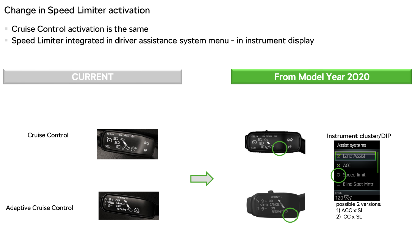

I've just noticed the steering wheel now has a button presumably to switch from ACC to limiter. That's one of the annoyances of my current car, having to go into the assist menu
That one enables Travel Assist (lane centering at all speeds).
That's one of he options I didn't select, would explain why mine is blank. Does it work well?
You know there is a button on the mk3 (non FL) ACC stalk to switch between ACC and limiter?
They have a facelift.
Yeah missing from the FL. Luckily the scroll wheel is tactile, but it's still 4 clicks to switch modes which is annoying
