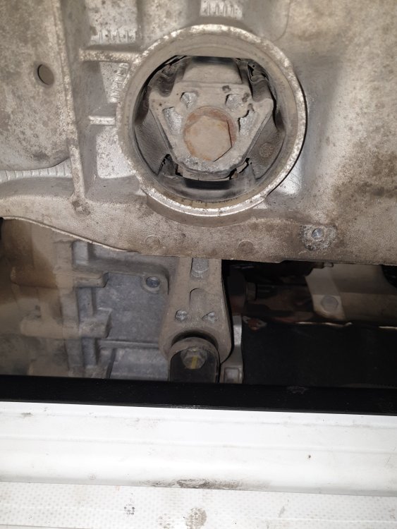

I'm planning to do mine this weekend, in-situ without removing the subframe. Once the old one is removed, it doesn't look so tight that the new one can't be drifted back in, based on the videos I've seen.
@NCR1, this is my original pendulum mount/torque arm/dogbone mount bush and you can see the cracking in the rubber (after 200k miles)
Is it worth replacing it with the APR mount equivalent? Heard that the aftermarket mounts can improve throttle response/gear changes etc etc.
Aftermarket mount or insert makes gear shifts feel super precise and positive and eliminates engine rock and reduces front end lift. They feel great, but all tend to transmit more noise and vibration to the cabin, if you can live with that.
I've just removed my Powerflex insert as it was too harsh. Attempted to fit a new stock mount yesterday, and failed after snapping one of the bolts on the subframe...
