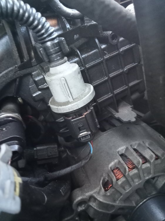

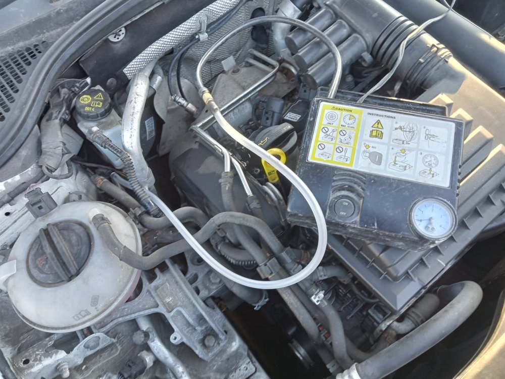

I say pressure as it only seems to be about 0.3 bar, it seems like there may be a relieve value somewhere in the EVAP system (see bellow)
I was able to replicate the pressure in the tank by forcing air back into EVAP line, but it wouldn't go above 0.3 bar.
No fault code for the purge valve, and it does have an arrow on it suggesting that it may be one way.
Tested it and it doesn't pass air either way, but this was with the engine off, so it shouldn't anyway under that situation.
So at this point I'm concluding that either, the valve is operating correctly, but when opening allowing manifold pressure back to tank.

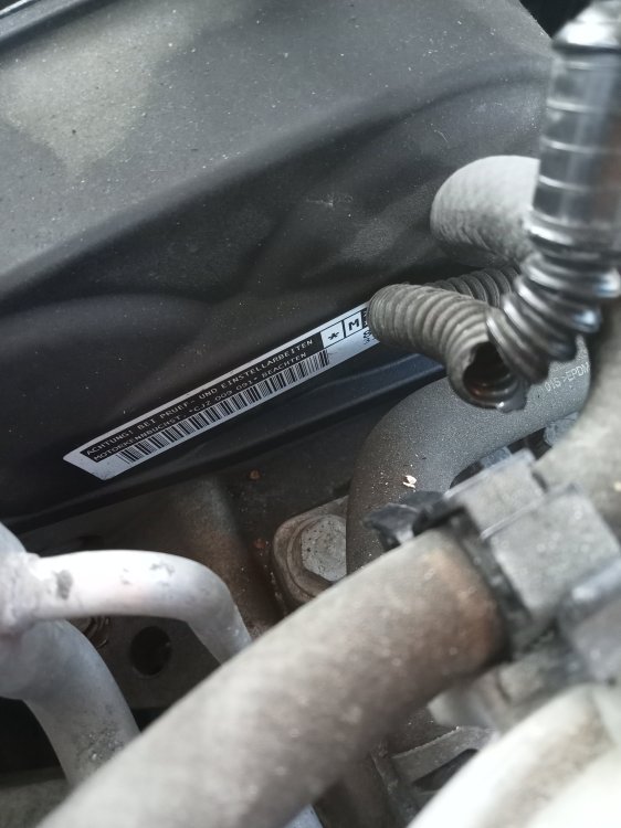

Just thinking I haven't checked for a blockage in pipe from the valve to manifold, so will have to check that aswell.
Of course this happened while removing the pipe, Arrh why plastic😠 and not rubber.
So with the pipe repaired, and engine fully up to temperature.
At idle the purge valve solenoid is constantly being energised, rapidly fluctuating, and opening and closing (repeatedly) roughly twice a second.
This seems excessive?
Also interestingly with the pipe broken and open to the atmosphere, the tank still pressurised.
