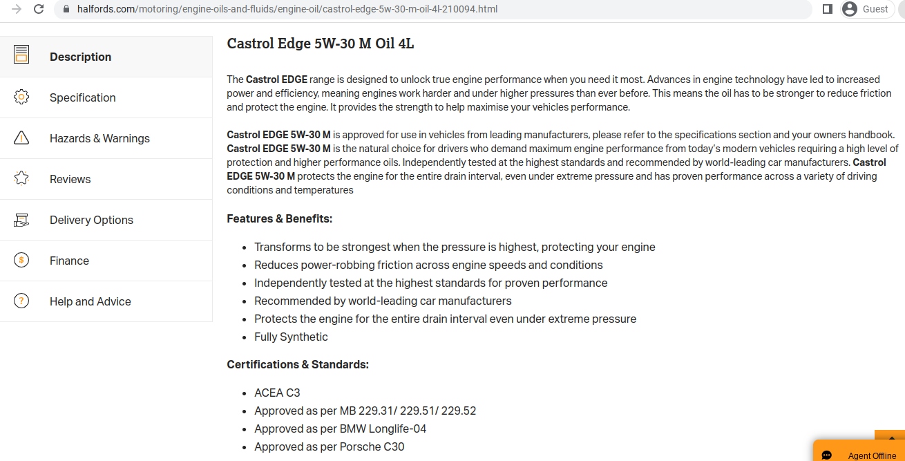

Any ideas what the difference between these 2 is? LL (long life) but what's M?
VRS Diesel DpF remapped. I must say I used M as a top up and could tell the difference straight away felt so much smoother and quieter.
You need to VW 504 00 / 507 00,
so 5w 30 FS III  (that is Long Life) even if doing fixed oil & filter services with a TDI)
No idea about the 'M'.
