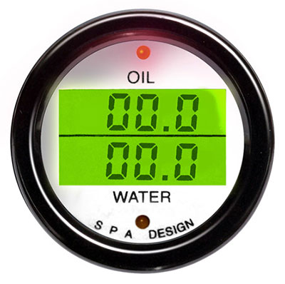

I went for the rather hardcore option - My (combined) coolant and oil temp gauge was installed during a service, so the sump was emptied and then drilled to tap the sender into the sump itself, about 2" to the left of the sump plug. Seems to work well, but I have to remind myself that the oil in the engine might be a few degrees higher than that in the sump - Gives me the best idea of when the engine is working hard though. :)
Mine looks like this, only it's black and has no "oil/water" on it - I just know the top one is oil and bottom is water on mine. :D
