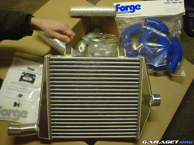

So i bought some stuff:

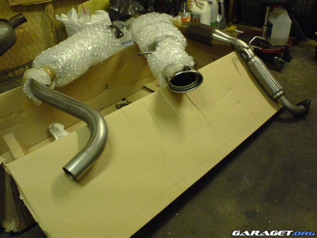

-Blueflame Exhaust

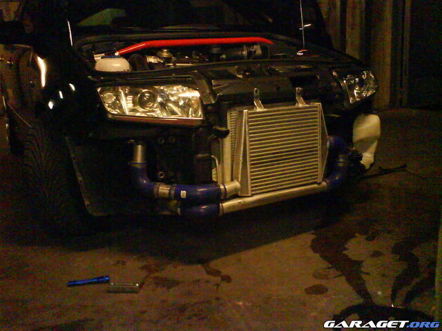

-Forge FMIC

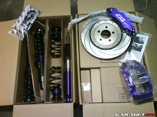

-D2 Coilover kit
-D2 330mm with 8 Piston
-Remap by V-Tech to 189hp/435Nm
After this the car had much better preformance and handling!!

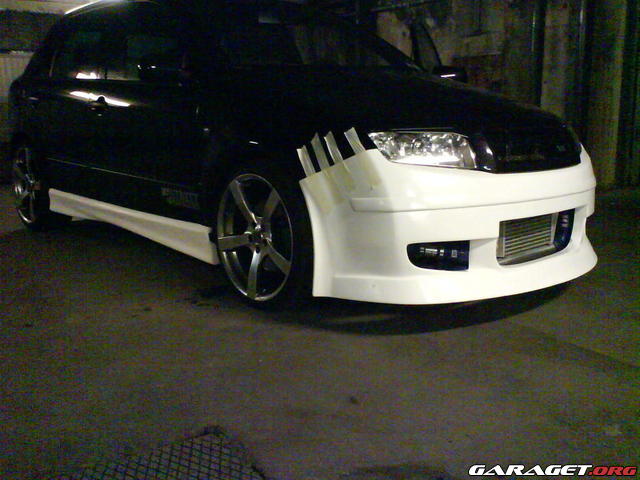

But i was not satisfyed with the look.. so i was scanning the net for styled Fabia and at first the WRC kit was on mind but to much work.. than i found this kit:
I dident go with the weels on this pic as you know ;)
At this poit the car looked like this:
After i ordered all things i started to put the pieces on place:

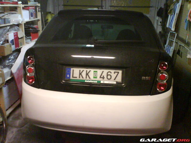

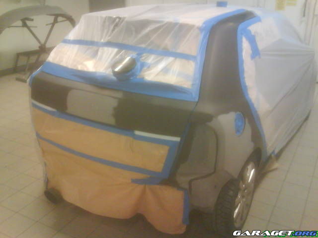

And i had a little accident on the right side by another car, so i was down to a mate to help me fix it and when we did it we get ride of the "Skoda" gadget on the hatch:

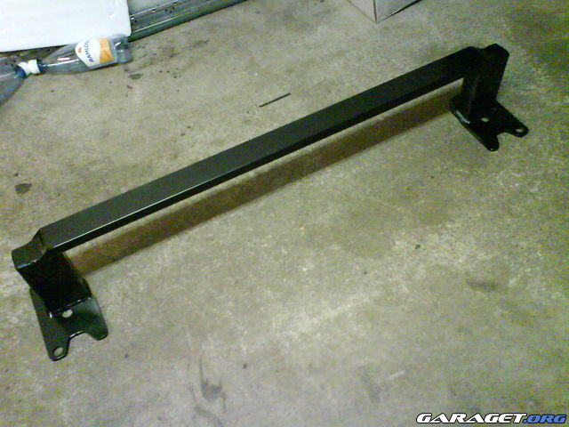

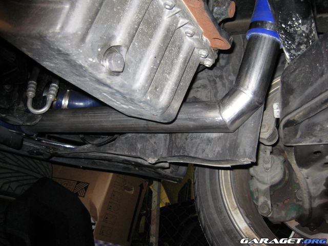

An i did a new crash beam to make the front fit:

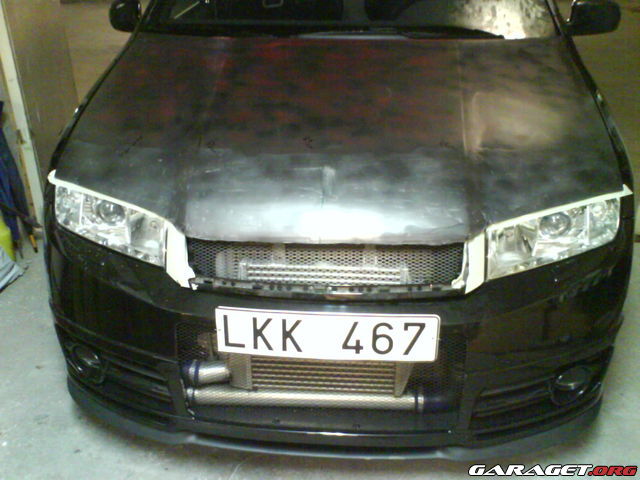

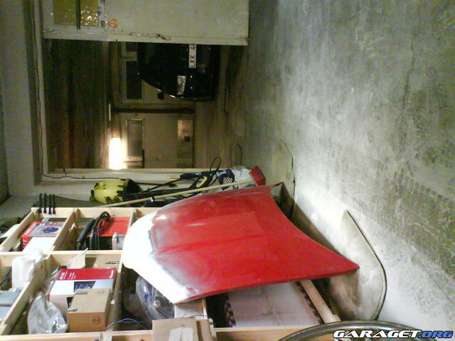

After this i started to make the hood:
An the last things i have done in 3 weeks to get the car ready to "Elmia" its a big event in sweden ther many styled car will be in April!
Then the finish results!
The 2 pic above are taken 09.30 in the morning before i vent to "Elmia" and i have worked with the car al night!!

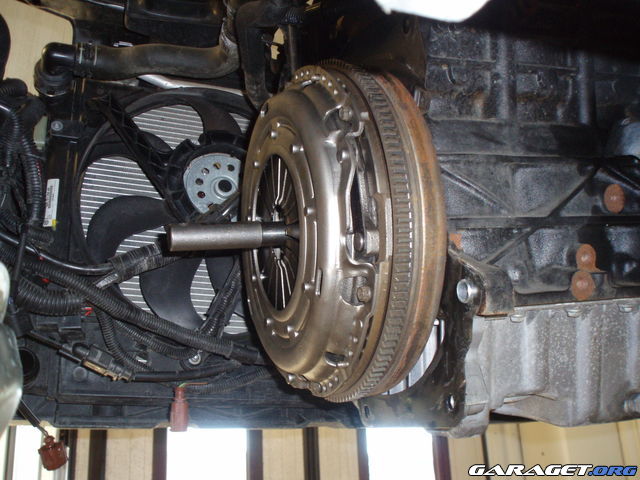

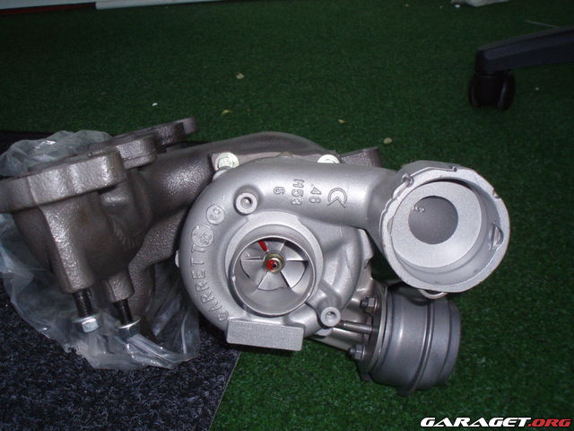

Then I started looking for another upgrade turbo and clutch:

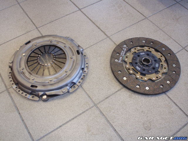

Here monthing clutch:

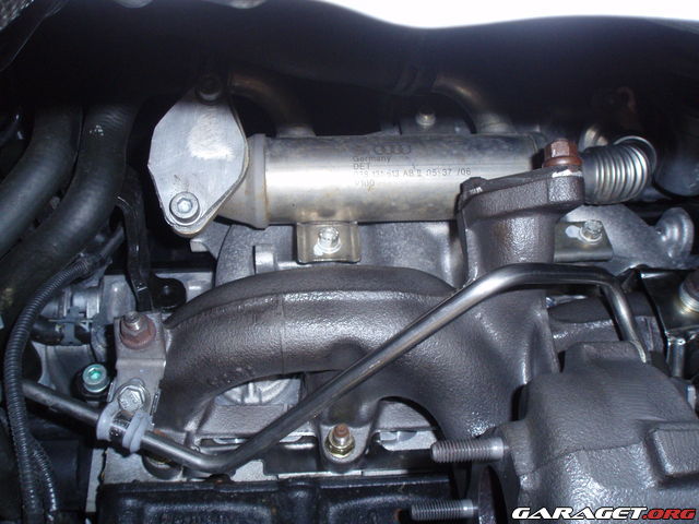

And here plugging the EGR

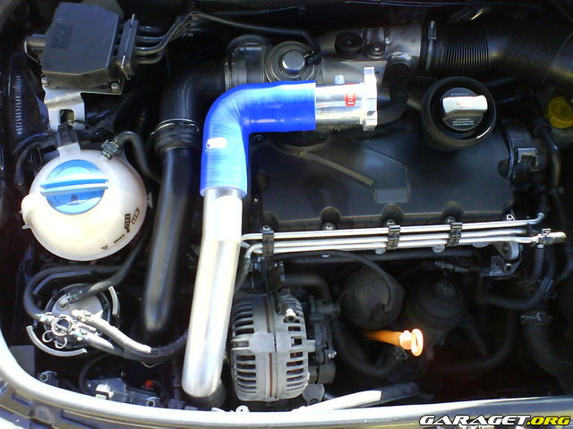

when everything was together I went to V-tech and remap the car, but had some problems with that hose jumped when we loaded on .. so we are not charged with more than 2.0 Bar when we got 216hk 460Nm.
but now I got fixed so hoses not to jump again:

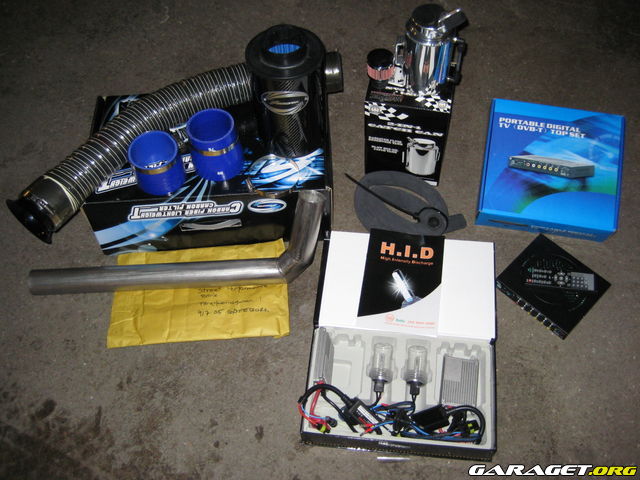

And some more stuff:
And all mounted on the car:

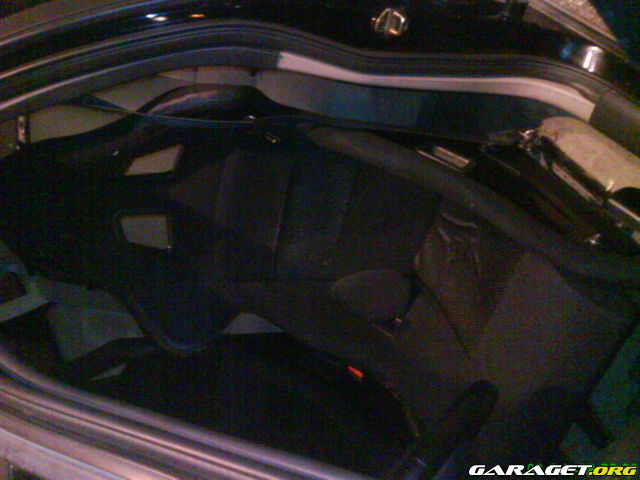

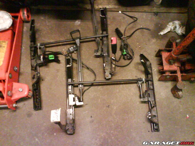

forgot to say that I have Sparco PRO2000 copies in the car to:
Bad and old pic (not in my car)
As I was based on the undercarriage of a crash car:

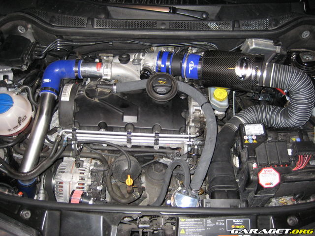

a full engin specification of the car:
Turbo GT1749VB 22 Hybrid
Sachs clutch and flyweel
Seat intake
Simota CCI air box
FMIC Forge MotorSport IC
BlueFlame 2,5" exhaust with cat
Plugged EGR
throttle housing gone
Alu pipe and samco hoses all over
catchtank for crankcase?
Tune by V-Tech in sweden to 216hp 460Nm soon more after remap

Are the extra HIDs for main-beam or are they upgraded bulbs for the existing Xenons?
The HDI are H7 55W 6000K slim that i will mounth in main-beam :)
I have standar xenon D2S 8000K ;)
