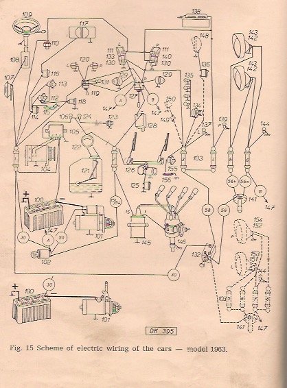

A belated update on my classic Octavia. The Coronavirus has really slowed things down, and coupled with TWO moves of garage means I've not really had much chance to do much, although it is still able to run (but not yet stop....) under its own steam (well, petrol!) I'm planning to convert it to negative earth, to permit the future fitting of a decent stereo. The dynamo has been converted by a local experienced auto electrical company and I'll reverse the coil's connections. Beyond that I ought to be O.K.... I've discovered that the temperature gauge isn't really a temperature gauge, as there's no electrical connection whatsoever; it's what's called a tele thermometer, which records the engine temperature and displays it remotely on the dashboard, so it should show the temperature regardless of whether the ignition is on or off.
The other odd thing is the fuel tank wiring: I can't fathom out why there are two feeds from the gauge to the tank! Every fuel gauge I've ever worked on has a simple feed from the gauge to the tank and the float acts as a variable rheostat, passing less or more current as the level rises and falls. But not the Skoda Octavia...... Has anyone else noticed this? I've attached a wiring diagram, to show what I mean:
