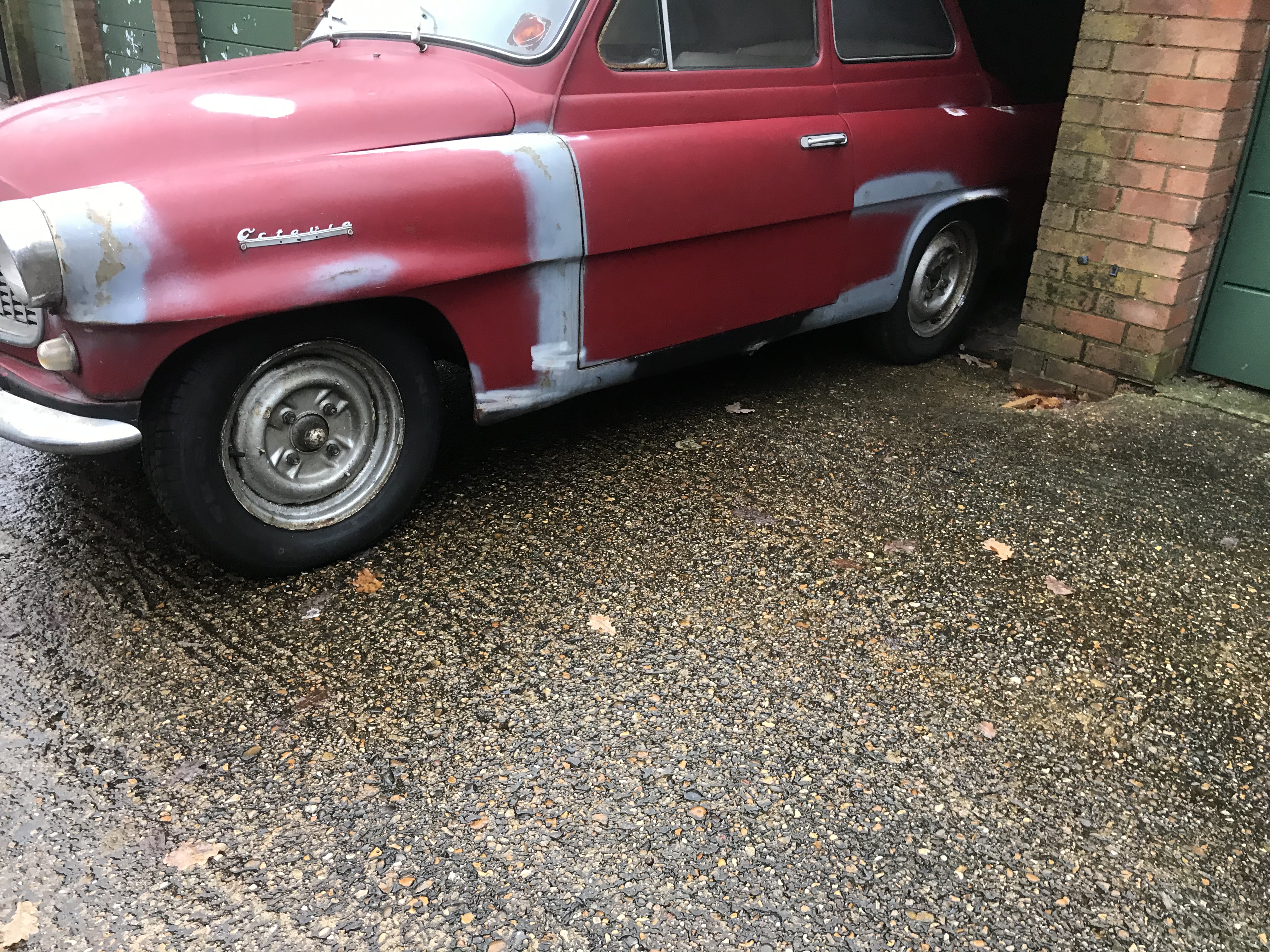

Twelve years late in finding this thread, but I have a right hand drive 1961 Skoda Octavia Super! Any idea as to where I could find some symmetrical headlight lenses? I drop into this forum regularly!

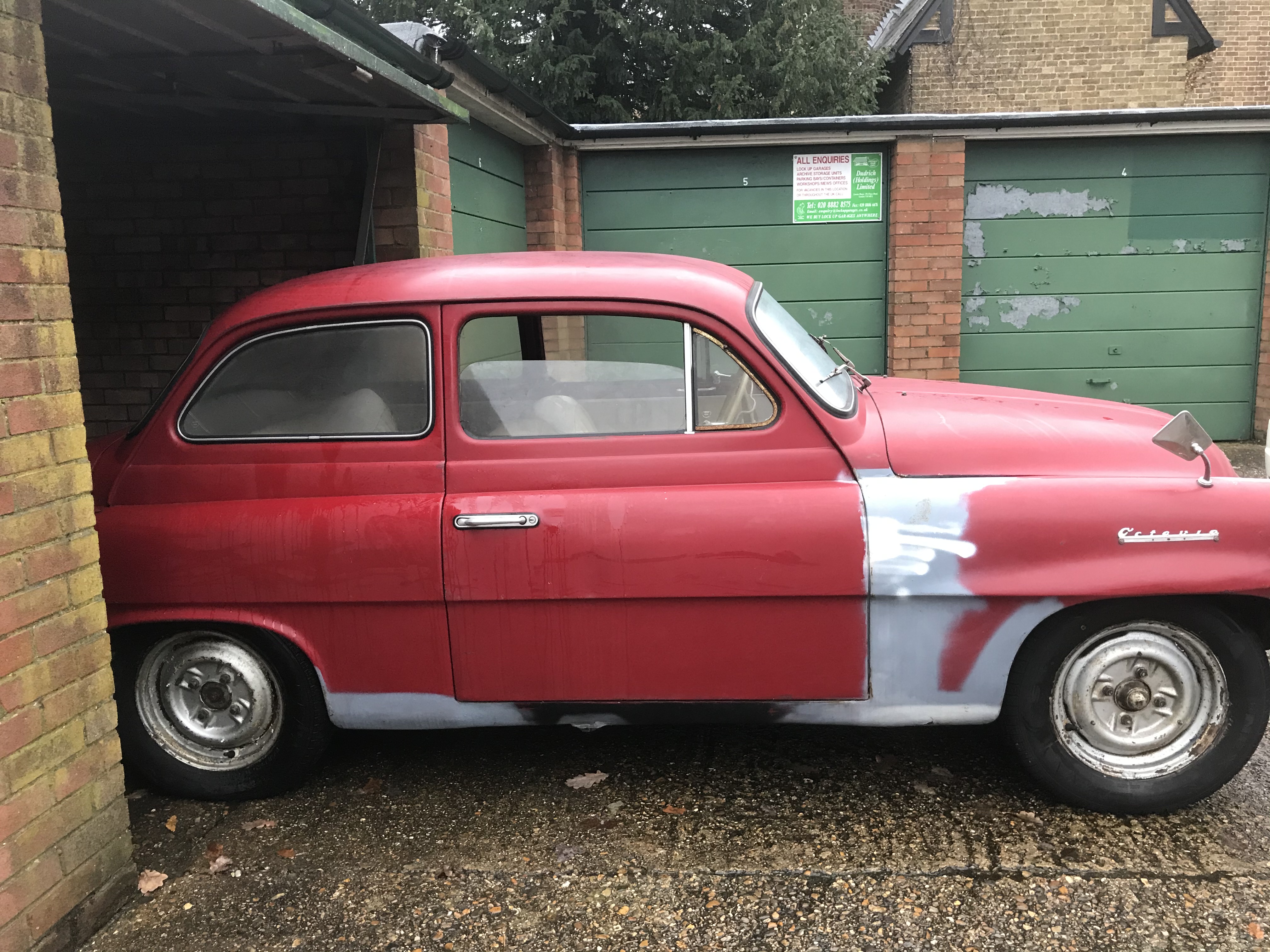

As requested! It's what mat best described as "a work in progress", but the engine now runs and I'm sorting out the electrical gremlins as quickly as I can, although I need a near-side headlight lens....
Thank you for posting! I love the shape of the early Octi. :)
Any ideas when you might get it on the road?
I wish I could help you with the spare. Might it be worth trying a Czech forum?
Hi! Thanks for replying. I've tried a couple of Czech sites, so far without success, but hunting around some Italian motor scooter sites has proved quite promising.....
As to when it will be back on the road, I have to reassemble, adjust and bleed the brakes and get the engine going before it'll be running. I was a V.W. trained mechanic in a previous job (well several jobs ago!) which helps.
With your VW background, hopefully you will get the old car running easily. Fingers crossed for no problems!.
The Octi looks to be in fairly rust free solid condition. Is the underside solid? Are you planning on a full respray? I like the way it looks. Be tempted to sort the wheels out, roughly colour match paint the primer and use as is.  Patina and everything and it looks great for a 60yo car. From the photos, the interior looks good too.
Keep up the good work Andyroo! :) :thumbup:
