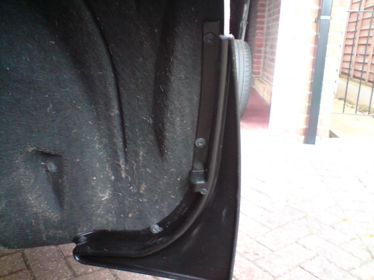

i tried fitting the new shape, rounded, mud flaps to the back, wheel off, hot water etc, but the holes in the liner are too far over for the edge of the mudflap to reach
The top hole aligns, but the other holes are on the edge and once the arch is in the groove, I cannot move it any further to the right in order to align the holes.
So wheel back on, no rear mudflaps:(
Fronts were fine.
Any suggestions welcomed

You have to drill new holes in the flaps to match those on the car.
Fronts were fine.
Thanks
Hope the attached image helps.
I would have but 1 hole was right on the edge with the other being past the edge.
I could not move the mudflap any further in as once the bumper was in the groove, there was no play in it, despite it being in hot water.
Thanks
Thanks, the second and third holes were past the edge
