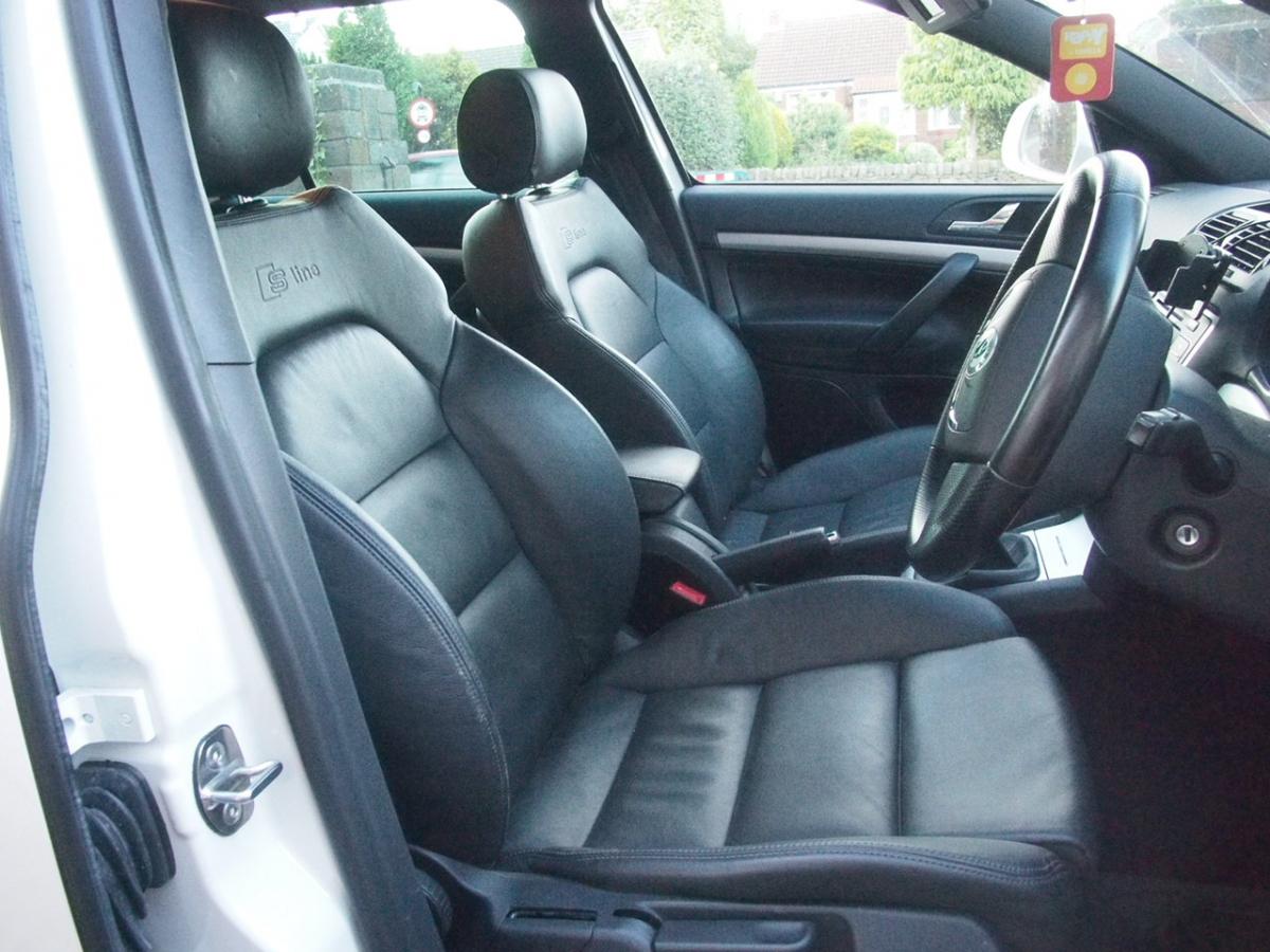

I have fitted some A6 S-line leather seats.  Electric lumbar plus extendable thigh support (who the hell uses this???). Wider base / less aggressive bolsters and longer bolster so doesn't doesn't cut into my thigh.  I'm very happy with them.  Anyone want a set of mint vRS front seats?
Fit fine though need a mounting lug grinding off.  The airbag connector is different though, I've not wired mine up yet but looks easy enough. Likewise needs a bit of faffing (new climate control panel and loom) for enabling the heated seats and electric lumbar: not got round to that yet either..

Got any pictures please? :)

Here's pics of my 2010 A6 Sline leather seats.  Suit the car really well in my eyes.  Could do with the rears recovering to match though!
