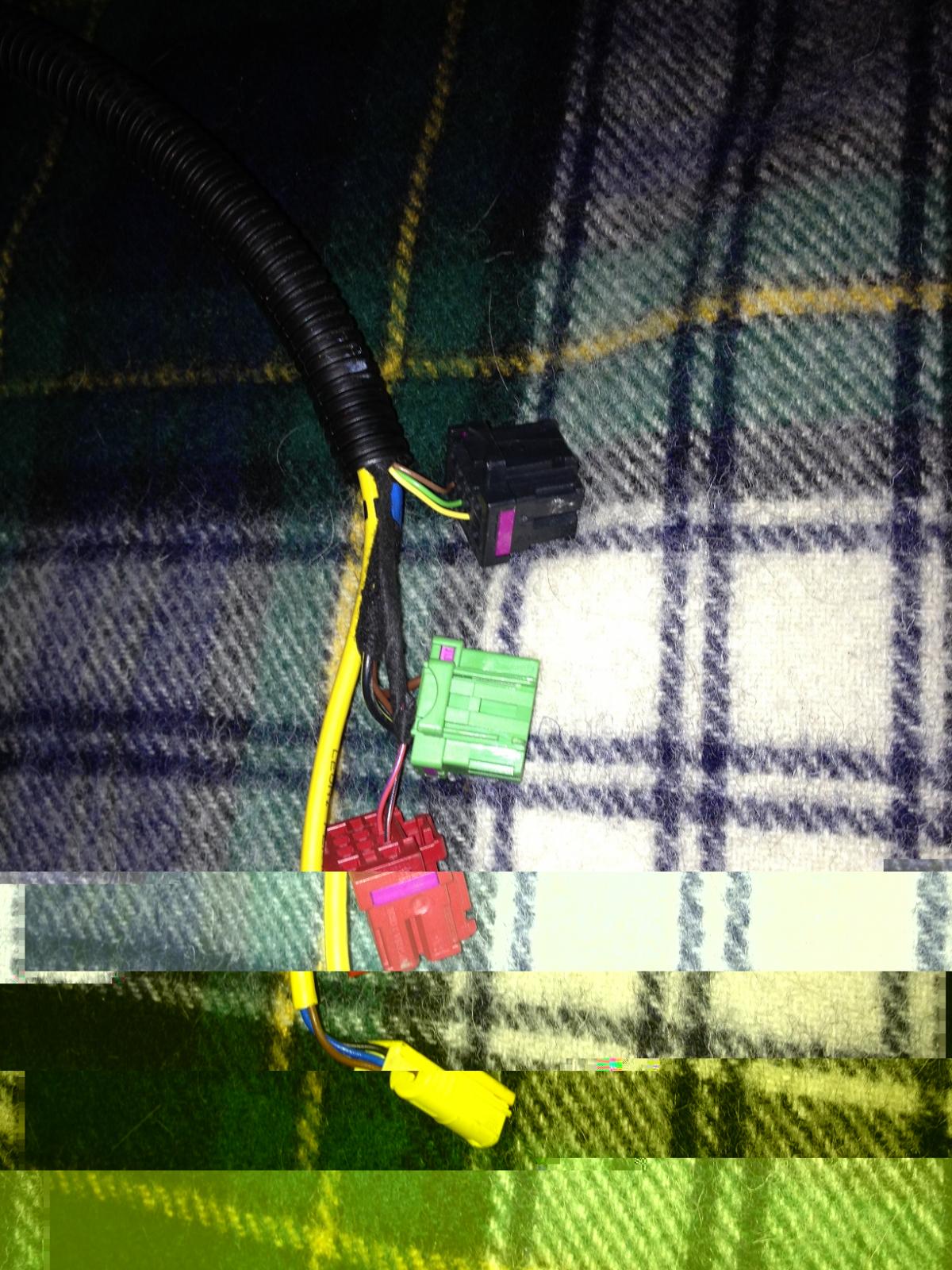

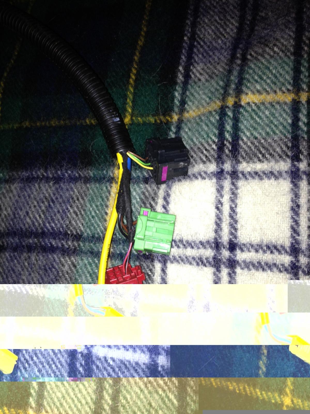

This is what the connectors looked like for my original seats. Note that yours may look different as it's a later vehicle:
The later seats (MY09) I put in used different colours:
Ignore the broken plastic casing; collateral damage! I would expect your seats to have the same connectors and wiring colours as the Mk6, as my second photo shows.

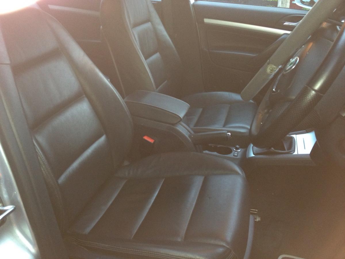

Photo of seats, sorry about quality, will take more tomorrow.
Did they just slot straight in without any adjustment? I'm looking at changing my cloth efforts for some luxury leather ones!
They had 2 locating lugs, the octavia seats only had 1 so the extra lug had to be ground off, apart from that they bolted straight in.
