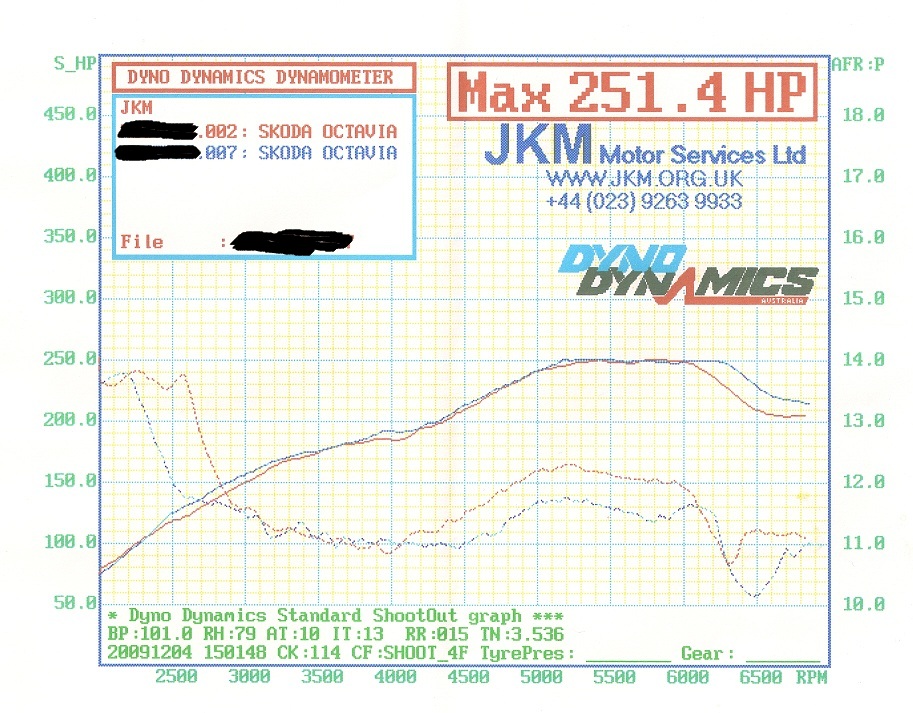

So I took the day off work on Friday and drove down to JKM.
Had a 'before' power run - so TBE, CAI and Bluefin stage 2 - made 251.2 bhp on the rollers. Not blown away as I've seen people get 260 with this setup, but not bad.
JKM then stuck the S3 intercooler and Autotech HPFP on while I wasted the day shopping in Portsmouth, I got back and applied the Bluefin stage2+ map, got the car back on the rollers.
Got a gain of 0.1 bhp... Yes, it made 251.3 so for all intents and purposes exactly the same. Power and torque almost identical to the first run, fueling was higher.
Friendly chap on the dyno (who, incidentally, has just ordered a brand spanking VRS FL and is planning on popping a K04 on it) thought I may have loaded the same software on the car by mistake.
I thought this might be possible, as when loading the stage2+ file onto the handset the bluefin desktop software kept giving errors, but it eventually seemed to finish loading.
I'm now sure this isn't the case however. Originally, superchips mailed me 1 file which contained my original stage1 and the new stage2 and stage2+ files.
When I put the stage2 on the car, a DTC error was being thrown and the ECU light was showing on the dash. Superchips then emailed me a new, standalone stage2 file which sorted the ECU light and has been on the car ever since.
So to get the stage2+ file on the handset, I had to load the original multi-map back onto the handset and stick the stage2+ on the car - the reason I'm now sure the stage2+ has been loaded is that my ECU light is on once more :) I haven't checked to see if it's the same error, but I will do tomorrow.
My thoughts are therefore either:
a) The Superchips stage2+ remap is rubbish
B) Superchips originally emailed me the wrong map
c) As the car went on the rollers 30 seconds after the map was loaded, the ECU hadn't adapted to it at all
d) There's something up with the car.
I'm currently working on 'c' as a theory. Having made the trip back from Portsmouth to Bristol, I took the car out on a 40 mile round trip as I met up with some friends and it definitely felt more lively than it did before, but I don't know if that's just me willing it to be. It's quite hard to test, as traction in 2nd gear is impossible and you need a good stretch of road to give gears 3/4/5 a good blast.
However, I know nothing about this ECU adaptation malarkey. Would I really see no difference on the rollers? While I wasn't necessarily expecting a massive increase in BHP, I thought the whole point in fitting the HPFP was to see mid-range gains in torque due to the extra fueling available, but the graphs are literally identical.

Timmy I would speak to Superchips first thing. It doesn't sound like you have been sent the right map.
As for adaption well if you have just reflashed the ECU it is going to be very keen and eager to find out about its new surroundings. So once again I would question the map.
Sorry to hear of your coming together.
Slightly off topic how come the Autotech pump?
Edited by Hedge
Did you check your rail pressure before, did you actually need the auotech?
I would imagine the ecu would adapt very quicky to a certain extent and there should have been concidereable gains. It's quite cold today so maybe the intercooler wasn't needed today?

250 from stage 2 is not that bad TBH. redrobins stage 2 revo GTI makes 245bhp consistently on JKMs rollers. His only stage 2 mods are a miltek TBE and Neuspeed discharge and INtercooler pipes.(obviously add an intake and then your looking between 250-260BHP)

I dont think you can load the same map. If you have the same map on the handset it will only give you the option to remove bluefin. If you have a different map it will give you the option to upload bluefin. Did the same with mine mate, had to reload it down from the net before i could upload it.
Sort of agree, although not rubbish, you just expect more, as i know you do to as you mentioned before you wernt to happy. Its not rubbish, its just not 100% (250bhp is still a quick car)(it is a free upgrade from stage 2 onto 2+)
Very possibly could be that. You should have seem some gains full stop.
mine went straight on mate, and still made quite a large difference, however it did also adapt afterwards and got better.
What were your torque figures mate. Can you post your graphs up at all.
Nope haven't checked - that's one step further than my limited know-how will allow, unless the Bluefin is able to log such data. Regardless though, Superchips are quite clear that their stage2+ software requires the uprated pump. I seem to remember you posting that you didn't fit your internals as your pressure/map combination was fine - that's to be expected though, until you have a specific map which requests more fuel than the stock pump can deliver?
Completely forgot about that - between that and the CEL then I'm doubly sure 'something' new went on the car. What's with the username??
Yup, and it's never been about chasing figures really, I suppose it feels like I've got little return for quite a large outlay, but that's the nature of modifying cars - once you get past the stage 1 remap the law of diminishing returns will get you every time. Map wise, as you say I have only paid £50 for the two additional stages so I've probably got my money's worth over the stage 1.
Peaked briefly at around 275, then level out at around 250 before dropping off at 5250rpm. Dyno-guy (that shall be his name until he identifies himself!) gave me a good printout of the before and after runs on the same graph - I'll get it scanned and up this week.

Torque peaked briefly at around 275, then level out at around 250 before dropping off at 5250rpm
That is extremely low especially for stage 2+.mine was making circa 300Ibft give or take. Revo stage 2+'s are making way over that.

Not sure about the adaption malarky. My car always went straight on the rollers after a map uploaded and the expected results were there.
Yes, what Ian said earlier makes perfect sense to me. When I first put the stage 1 on with the Bluefin the change was instant too. Think I've ruled adaptation issues out now. Thanks for all the input so far chaps. I had an email conversation with Michael from Superchips today. Very nice bloke, the same person who dealt with the CEL light issue so efficiently when I first loaded the stage2 map on a couple of months back. I emailed him the stage2+ map so he could double check that it is what we think it is, and that all checks out. Michael basically confirmed what I had expected from the map - realistically the gains from the stage2+ map should be felt in the mid range due to the extra fueling available from the uprated HPFP [and requested by the stage2+ map presumably].
Michael has invited me up to Superchips HQ to take a look which was a pleasant surprise - I think I've seen this offer from Superchips on a few forums now.
I have been very pleased with the stage 1 map and the stage 2 wasn't half bad - certainly worth the additional £50 I paid on top of the already very reasonable charge for the stage 1, so I don't think Superchips owe me anything at all - visiting there is always an option I could look at later.

Here's the before and after BHP comparison:

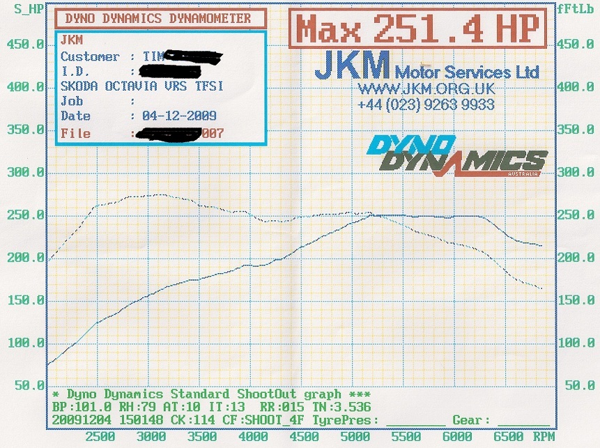

and here is the 'after' with the torque figure.
Updated stage2+ is now on the car but haven't driven it yet. Will give it a blast tomorrow but no reason to believe anything will change - it's just the de-cat version which will sort out the CEL light.
do you have the torque as well. Also do you mind if i post that on mk5gti as there is a guy on there with bluefin interested
Yes feel free to post - you missed the torque graph by about 30 seconds :)

you'll see it ina minute. Ill pop them in the thread in a minute so it will be one of the newly replied threads. he has just had his Twintake fitted to his stage 2 bluefin.
looking at your new graph. Its not all bad tbh. With a bit more adaption i think it will smooth out a bit more.
I think the power and torque curves a reminiscent of a stage 2 car though. stage 2+ cars should see a fair bit above 300Ibft (some cars have made 320Ibft plus)
what is your mod list.
Mod list as per my sig. The phatbox is worth 10bhp at least :)
I've seen a few people with around 280bhp with similar mods, albeit with a couple of extra pipes swapped over.
