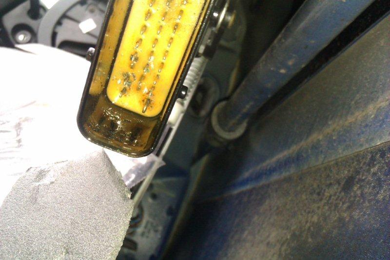

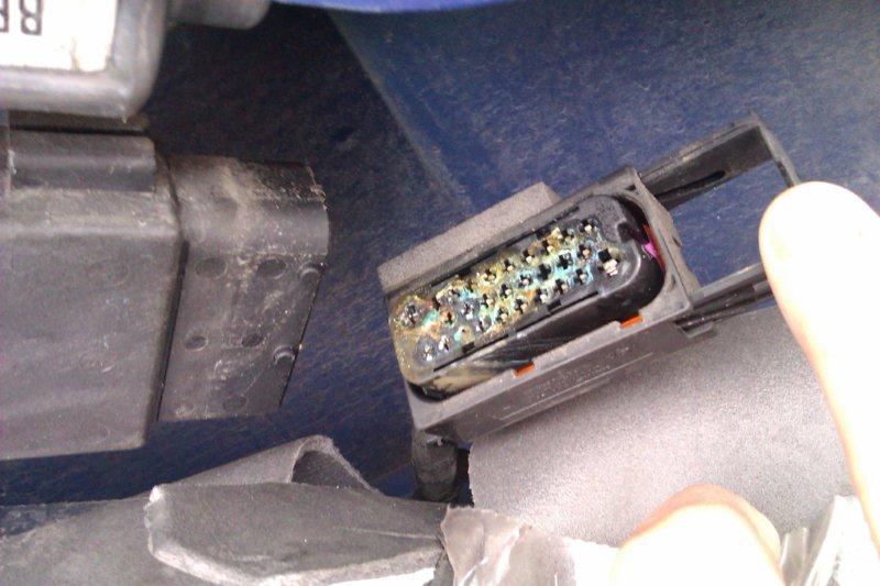

Next day, I striped door as I had not connect door cable properly and had a closer look at the motor controller connector. See pics. I cleaned with a toothbrush and WD40. ON our Octavia, the water clearly must get in from the top of the unit and find its way down thru the unit to the connector ( and not following the cable as indicated in other posts) .
So after cleaning and replacing , i feel the removal of teh corrosion ( and short circuits ) have fixed it for now; Sure I wil lreturn to this.
see 2 x pics before & x after

Which connector is this?
Pictures are from  motor controller connector.found in drivers door.
To the window motor?
