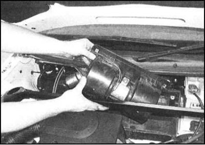

If it doesn't work on any speed, then I'd suspect the motor - it's easy enough to unclip part of the motor housing (under the bonnet) and see if you can spin the fan (I had an old Escort that had seized up, but freeing it off by hand sorted it).

yeah, those pesky little spring clips that hold the heater fan box together have a habit of going 'ping' then you never see them ever again, they just dissapear!!! :wonder: or land in the throttle body like they did on mine, then somebody very helpfully put thier foot on the accelerator pedal so i had to fish them out with a magnet..... anyway. be careful
Ok, I've actually taken the whole motor out, just to have a look before I do buy a used/new motor. On the two magnets that spin the coil, it looks like one has become loose. I've put it back on and it now works! :D

just received my order of little bits, I have the resistor here to be replaced but where is the location, is this going to require removing the whole assembly or can I leave it in situ.
If you have car without AC, the resistor pack is in the engine bay, on the right side of the heater box (in the driving direction) - you'll se wiring loom going to it.

I swapped out the resistor last night, was fairly easy with the right tools and without having to remove anything. I took the car for a little drive, I did notice that the air was coming through Hot but still it doesn't vary much on different speed settings. I don't know if this is overkill but I'm tempted to use a velocity meter to measure the air speed and see if there is any change. Could it be a possibility that the motor has seized, or the brushes are damaged. If this is the case, how easy is it to get access to the motor, I'm wondering if I could maybe free it up by hand. Has anyone else had any experience of this.
