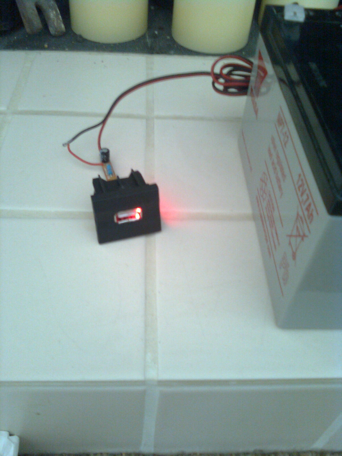

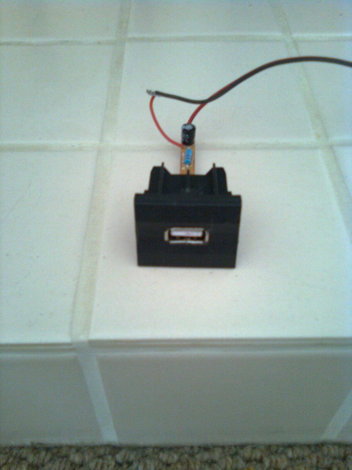

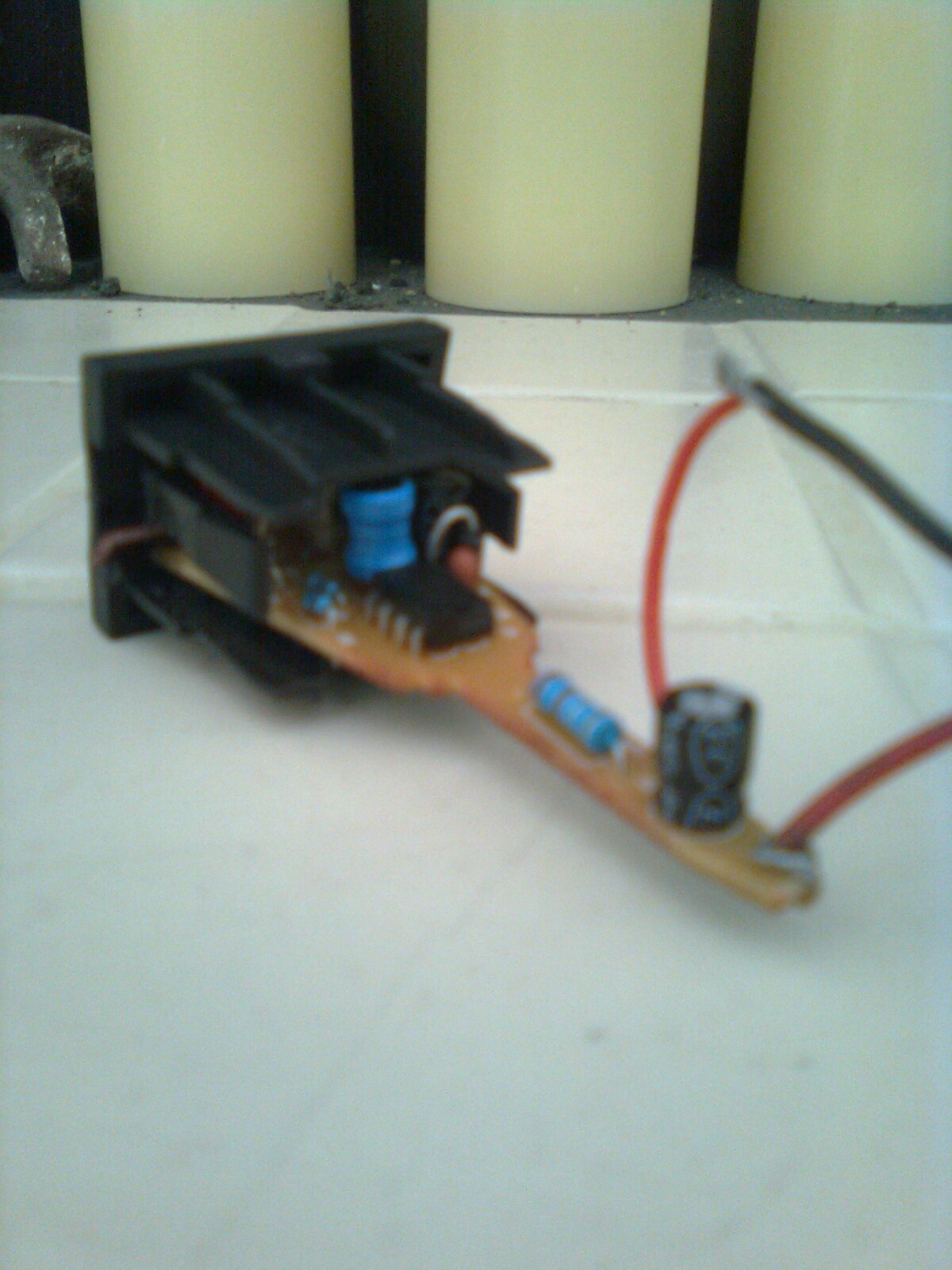

Thanks for the help guys... If anybodys interested heres a few pics.
I just have to tidy up and secure the connections on the unit. And fit it of course...

Very tidy mate :thumbup:
Looks pretty good :) If I could be arsed this is something i'd want to do!
Looks good that. Nice work :thumbup:
