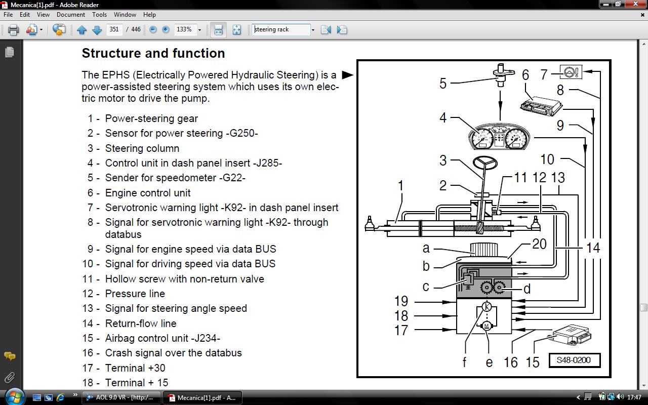

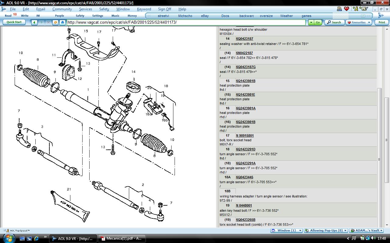

Gona get battery checked tommorow but been reading about power steering angle sensor, from what I have been reading its located on the column?
Top, Middle or Bottom? what does is look like? Any one go a picture of it in situ? and finally any ideas of a price and is it a DIY job.

LOL are these showing the same part?
Is located inside the car or from underneth the car?
Cheers
The PAS angle sensor attaches to the base of the steering column. All done from underneath.
It is part 18 in your first pic above and kind of has a semi-circular notch in it which sits around the steering column. The wiring for it stretches over to the power steering pump which sits kind of inside/below the nearside front wheel arch. :)
Cheers
Dont forget there are various types depending on year of car. My car is 'W' year 2000, and the sensor is permanently connected to the lead,with a plug on the end. Newer cars have a sensor with a socket on it ,and a lead with a plug on either end.
