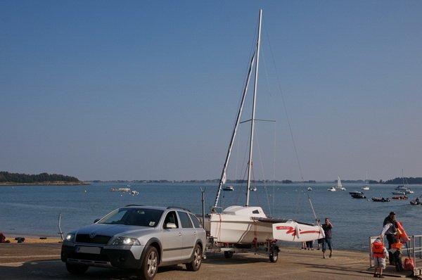

I'm looking at getting a new Scout to tow a small sports yacht, in Australia the listed max towball/bar weight is 75 kg do you know if this can be increased, how heavy would your caravan be?
Marty
Edited by Marjac
75 kg is the max static downward mass that can be put on the towball. Most caravans are balanced well enough that the caravan axle carries pretty much all of its weight. The max the car can tow is something like 1400 kg I think, but it may be higher for the scout as I understand it has a lower 1st gear.

I agree, it tows very nicely indeed. Must say I think my mpg is a lot less than that when towing my boat, but then it has perhaps more windage and is a bit longer...:
Tows brilliantly, even heavily loaded with family, boats, bikes & holiday gumpf, it never felt underpowered or missed a beat (or a footing, come to that):
Thanks for your reply, I've just checked my boat trailer which is about 1,000kg (with boat) and the towbar weight is about 100 kg so will have to see if I can reposition and/or repack the boat on the trailer to try to lighten the towball weight
To start with I can take the ancher out of the front of the boat!
Most of the caravan/towing information I can find (in Australia) suggests a towball weight of about 10% of the total loaded weight of the trailer/caravan so will have to be carefull by not making it too light ie not adding weight behind the axle to counter balance etc
