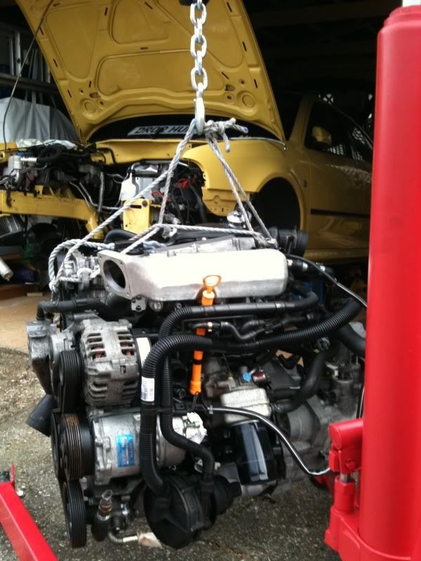

Firstly, sorry to Leeboy for blatantly stealing his pictures, but they are perfect for my quest to find a boost leak somewhere. I've posted before that I have a whistle that's getting louder as the days go by. I need to sort it before something pops or falls off leaving me stranded. I have never seen the engine from this angle, but a lot of you on here have done many times. Could you please tell me which of these pipes could be whistling? As the turbo spools up nd down, the whistle rises and falls in pitch. It isn't the airbox as I have asked the wife to rev the car whilst I listened. It is definitley coming from behind the engine and therefore your advice would be welcome. As it's our only car for getting the family around I'd rather not wait until the car's out of action to sort it out. Also, can these things be checked from above, or does the car need to be off the ground?

As the turbo spools up and down, the whistle rises and falls in pitch. It isn't the airbox as I have asked the wife to rev the car whilst I listened. It is definitely coming from behind the engine and therefore your advice would be welcome. As it's our only car for getting the family around I'd rather not wait until the car's out of action to sort it out. Also, can these things be checked from above, or does the car need to be off the ground?

In the top picture you have posted the turbo is the thing the two large thick black pipes are going into, if either of those pipes aren't secure then you would hear more noise than usual although the chances are if that is happening the car would detect the problem, throw a fault code and go into limp mode.
