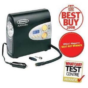

I use one of these to do my tyres with.
Ring 12v Digital Compressor
