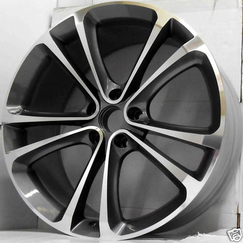

8.5x19 5x112 ET45 with 235 or 245 35 R19 tyres, that should fill the arches!! :thumbup:

Seriously I am thinking of buying these wheels, am I being silly going up to 8.5 from the 7.5 Zeniths?
Have a play with https://www.1010tires.com/WheelOffsetCalculator.asp
Points of reference to try in there for the before value: orignal zeniths without spacers = 7.5J, ET51 and my CHs which are 8J, ET43 which can occasionally just touch the lips at the back of the rear arches (with 225 tyres) if I've got rear passengers.
So if you think about it, your proposed setup has the wheel outer sitting ~4mm further out than mine AND you're thinking of running a wider tyre.
Edited by wega3k
Forgive the ignorance mate but I get the 225 40 R19 but can you explain the 'ET51' and the '7.5J' measurements?
Edit: just done the calculation using your link, I think those wheels are a no, no! 7mm closer to the strut and a whooping 19mm further out....... emoticon-0149-no.gif
ET - offset, lower = sticks out more
J = rim width in inches :thumbup:
Got it, that link pretty much explained it! emoticon-0148-yes.gif whats annoying is if they had the same offset as the Zeniths, I think they would be perfect! emoticon-0124-worried.gif
