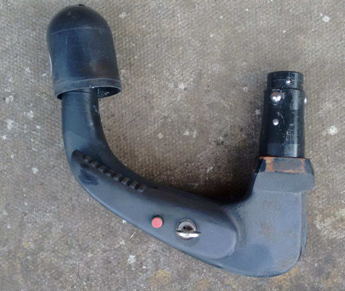

I was preparing my car to have the towbar fitted tomorrow - remove rear seats, spare wheel etc etc - when I spotted a Brucie Bonus in the spare wheel tray from the previous owner which the dealer knew nothing about either ...
OEM detachable towbar with dedicated OEM13 pin electrics ! :)
