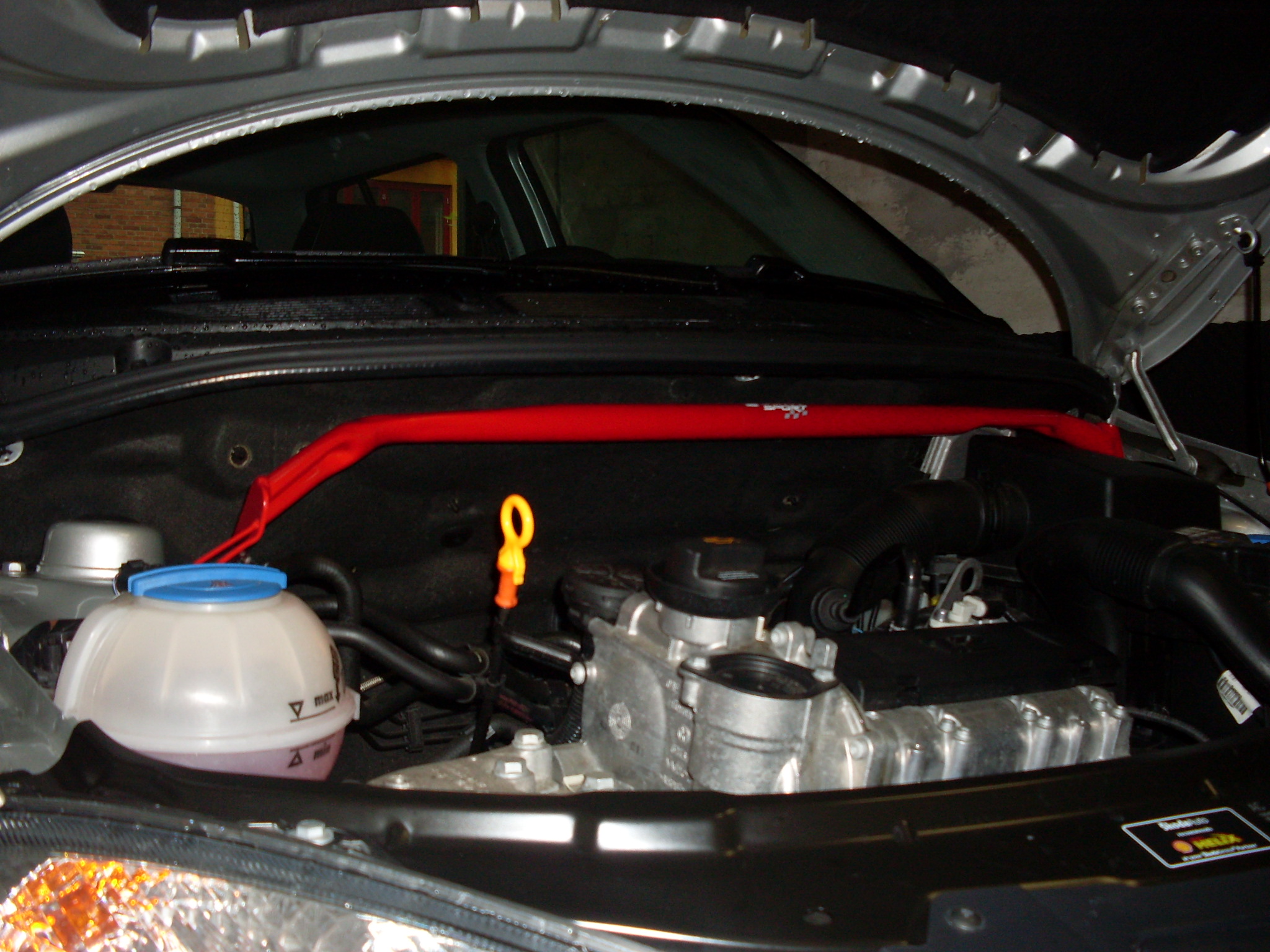

I have a strutbrace from Seat fitted with part no. 6L0071710.
Don´t know if it´s the same as for the mk1.
Bgds Dan
Bgds Dan
It sure is, that's interesting!!

You got any pics mate?
I got the strut brace and the Whiteline RARB though Sarah at Awesome.
