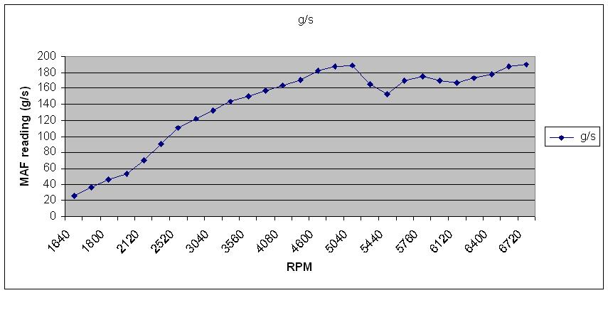

As the title suggests, I have an unusual drop-off in MAF readings after 5000rpm despite some recovery later on. Any idea what it could be?
the usual suspects such as MAF, MAP lambda sensor maybe. can y post up all your logs etc

Clean the MAF connectors and see what happens, otherwise, you might be looking at a new MAF.
Possible heatsoak due to too much boost and not enough cooling.
