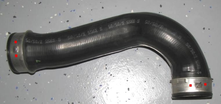

You can't really use jubilee clips on the standard VW type hose's, They are not a Hose over a Flange that you can use the jubilee to grip tighter. They are an aluminium flange with an o ring which fits inside another Alu or Plastic flange depending on it's location, These pipes have two raised lugs which the spring clip sits behind & stops it from pulling out. These lugs wear over time & the hose's do then pop off under boost conditions Etc. Most Vw boost hose's do show a little oil residue due to the oil mist being sucked back into the engine from the crankcase system, This then sweats through the joins & becomes visible......
If you want to use Jubilee clips properly you will have to replace the pipework ..
You can see the Two type of connectors below which fit together showing that a jubilee would be useless to aid Sealing.
