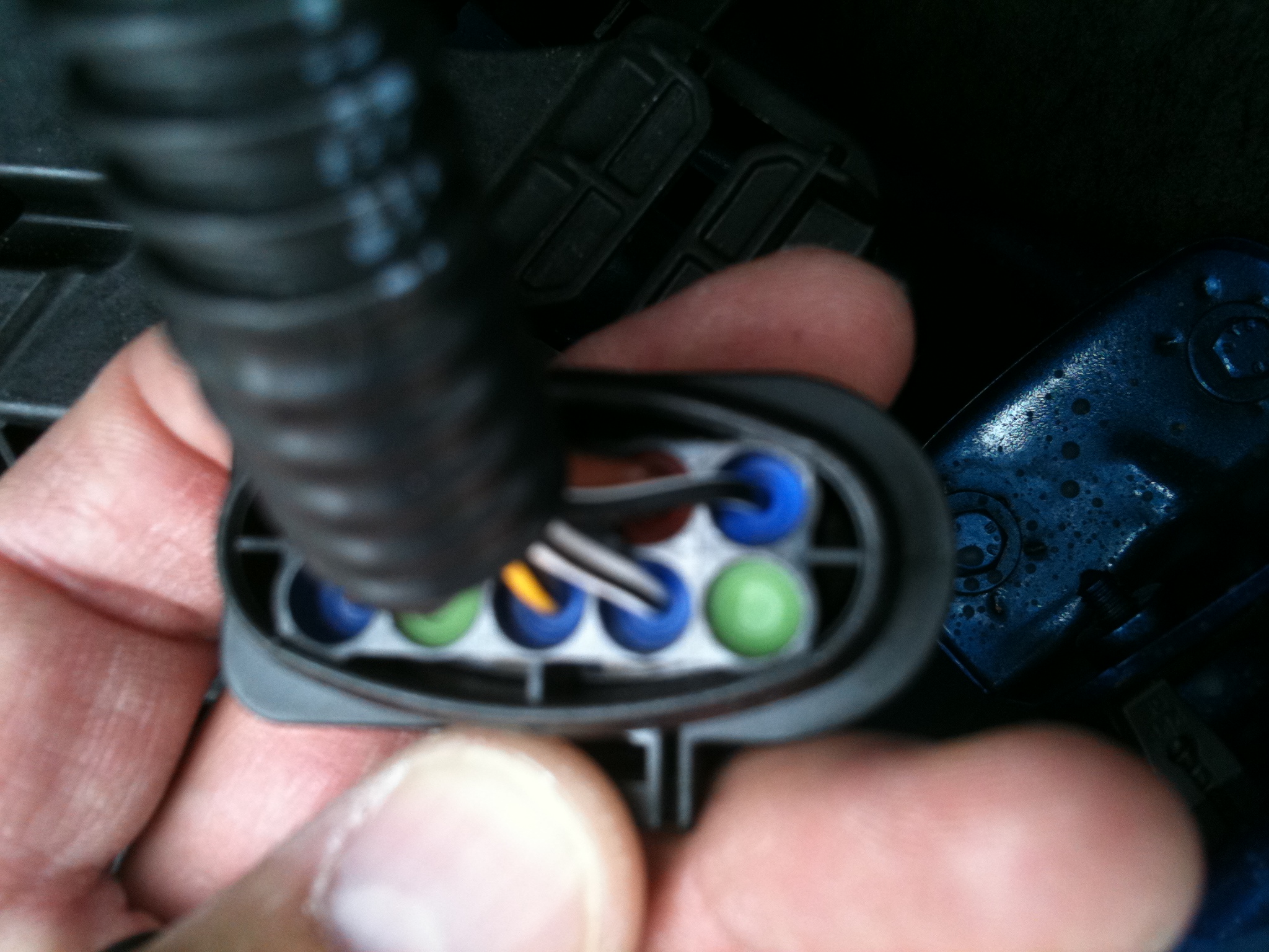

Well after doing a little work with the Fluke, it transpires that those b**tards at Skoda have deliberately not connected the +ve terminal on the eyebrow lights (see enclosed picture of the plug - bottom green "plugged" hole). This means an additonal set of connections from the eyebrow lights to the DRL wiring. Not the elegant solution I wanted and not only that but in order to get to the DRL wiring, the bumper is going to have to come off. Bugger emoticon-0106-crying.gif
