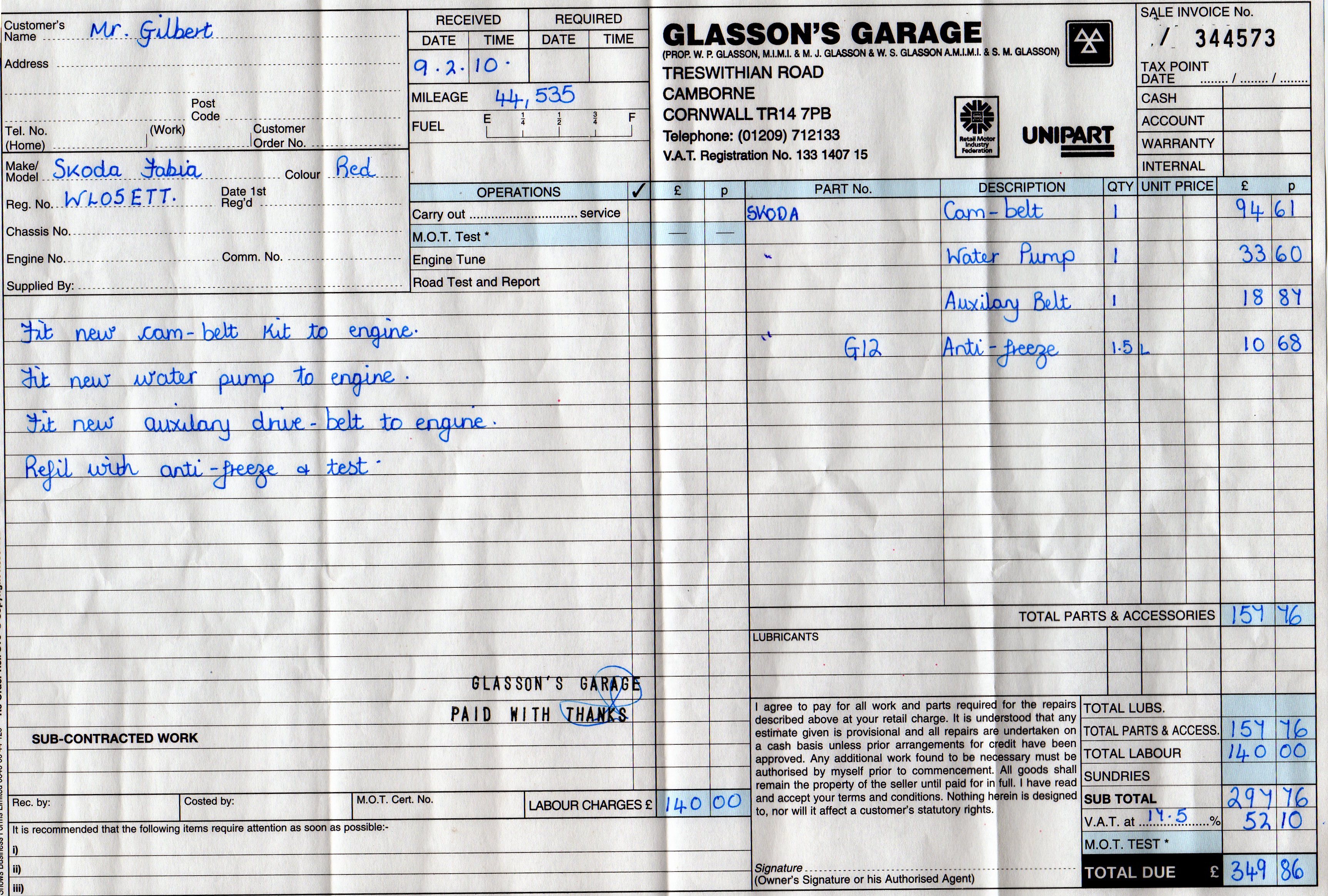

Attached fairly recent bill for 2005 Fabia VRS Camshaft +Auxcilliary belt +recommended water-pump+ G12 antifreeze renewed.
Brake components replacements you can carry out yourself, including 2 yearly DOT4 brake fluid change.
Loads of info on these areas on this site, do a recommended search around/ or ask.
Good-luck.
