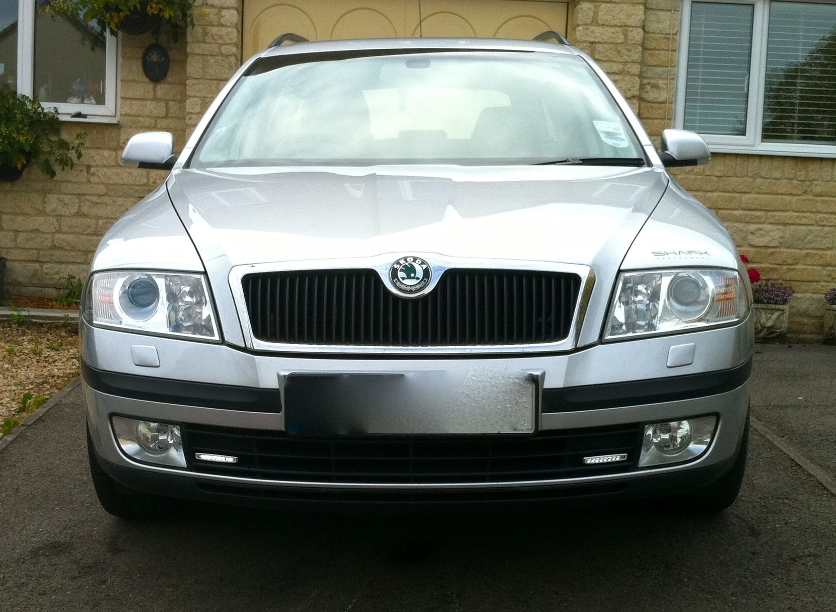

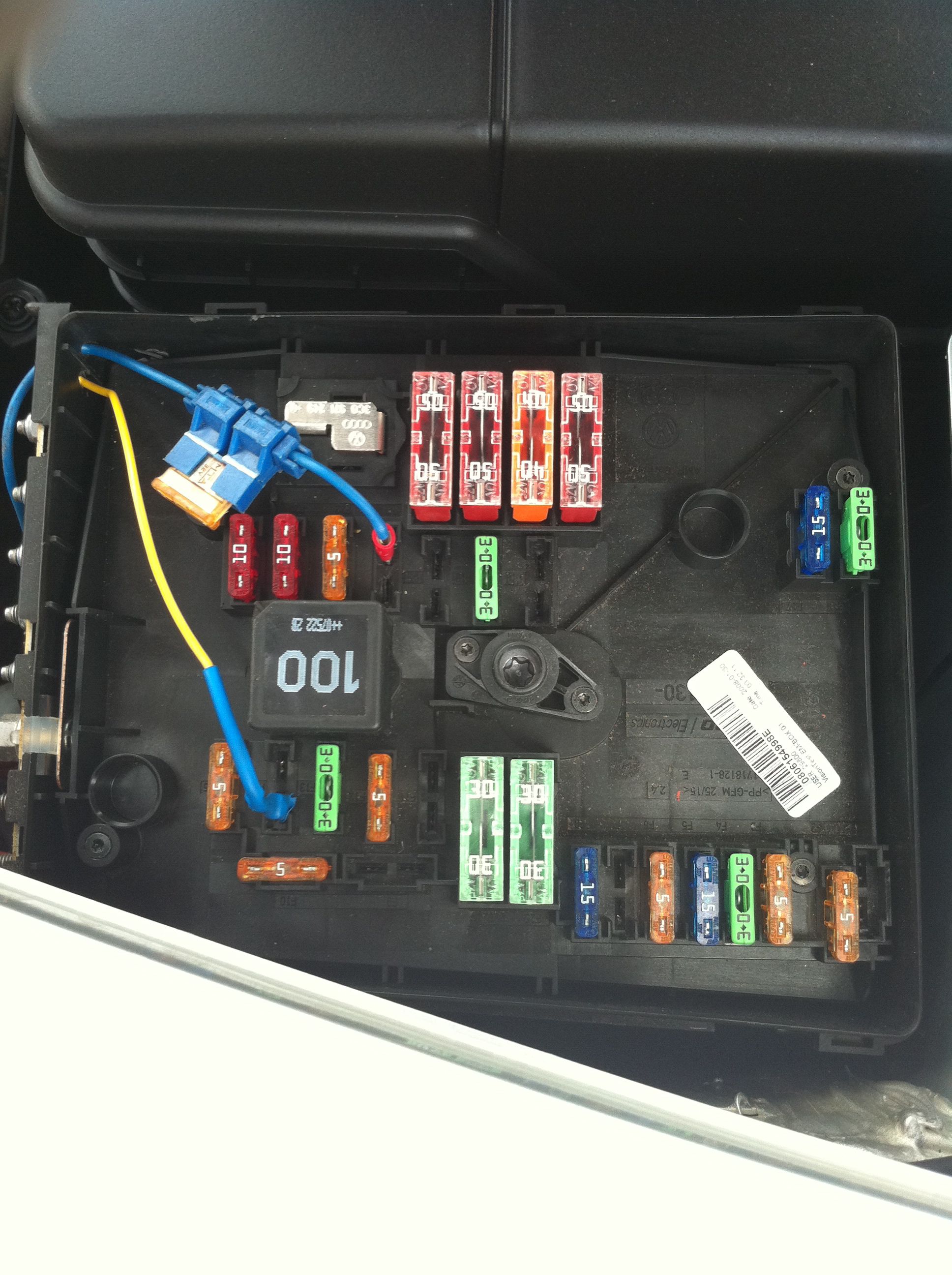

Hi Carl,
Hope this helps.
I bought a set of 5 LED DRL from Halfords at £19.99. I have stuck them using gorilla tape into the same parts of the grill as you have done.
I have used F21 in the fusebox on the r/h side of the engine. this has come out into a fuesholder with a 5A fuse which then feeds the DRL. The yellow wire is for the 12v suply to my 13 pin socket for the caravan.
Regards
Tom
Thanks Tom i'll give that a try :thumbup:
Where did you get that Fuse Holder from? Halfrauds?

Hi Carl,
Hope this helps.
Regards
Tom
Tom, am I right in thinking that the yellow wire is nothing to do with the DRL's then?
Carl,
The fuse holder is one I had in stock - I'm an engineer and I used to install equipment on to tractors and combines. You could probably get them from
Here
Pagey - yes, correct the yellow wire is for the power supply to the caravan.
BTW - I have not used a relay due to the lack of current that the LED's draw. If I had been fitting spotlights I would have done as they ca draw serious amounts of current so it's safer. The 5A fuse I have in the line is more than adequate for these LED'S.
Regards
Tom

LOL Patience young man. As i said the Sealant will take a good 18hours to dry and then the Painting is going to be another couple of days so your looking around the weekend :thumbup:

Here you go. Pic of the car when it was detailed :thumbup:
That looks superb. Might have to ah... borrow that idea. Like the colour-coded upper grill surround too.
When did you colour code the grille surround? Did Simon come to you for the detail?
I've had the grille surround for about 18 months if not longer :giggle:
I did the lower grilles about 2 months after the grille surround :thumbup:
I went to Simon for the detail
