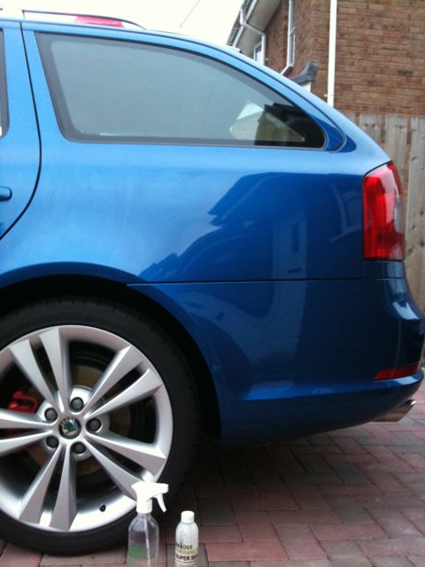

So before we start, my previous best attempt. There's no polish applied under this one. This is the Serious Performance Paint Cleanser, Serious Performance Super Polymer Sealant, topped off with Serious Performance Show Car Detailer v2. This combo is amazing on my silvery coloured BMW, but unfortunately it doesn't come out so well on darker colours.

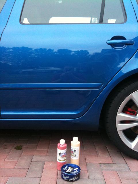

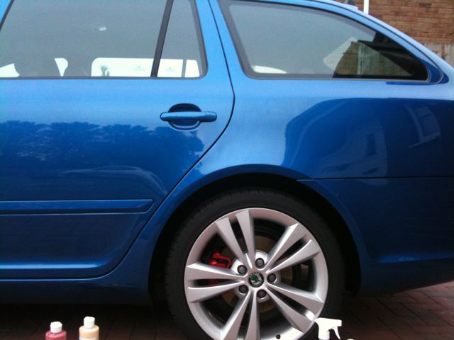

Clearkote Red Moose Glaze: Wow, ok so the door looked great, nice and wet after the Menz FF but RMG took it to a new level. This stuff is incredibly easy to work with (i just applied it using a clean finishing pad on my DA) and after buffing it, wow! I did the door in 3 sections so i got a really good idea of before and after. RMG gets a mahoosive thumbs up from me. But to be fair my voice counts for nothing since a lot of the heavyweights over on Detailing World and a few other sites were already rating this just about the best thing you could do for a dark car.

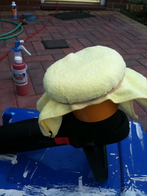

Next up was the Clearkote Yellow wax, now i hadn't found any reasonable quality MF buffing bonnets for my DA so i improvised with an MF cloth and 2 elastic bands
Does the job, might cut an MF down to size for future, one MF will give me 2 bonnets but trying to figure out how to squeeze a 3rd out of what would be wasted. Again the Clearkote stuff just blew me away even further. Wow!!! This stuff again was so easy to use but critically really improved the finish.
Now at this point i was blown away, no matter how good the EGP / Megs Classic Wax would turn out to be, it just wouldn't beat this Clearkote stuff, no way no how.
Then things went pear shaped. I used Megs #16 (it's a good wax when used on my Silver BMW) over the clearkote glazes and i might as well just have sprayed bird crap on the door at this point. This wax really took away from what was shaping up to be a phenomenal finish. As i was buffing this stuff off, my heart was sinking. What happened to my beautiful finish.
The finished article:
Lesson learned, Megs #16 is not to be used on top of clearkote stuff. I'm still deflated about this. Knee jerk reaction was to go order some Clearkote LSP wax but i need to cool down on the product buying front, can't fit everything in my garage, really tight on space and i'm 2.5 shelves on cleaning stuff!!! So i'll have a go at another panel with Clearkote but top with Megs Classic.

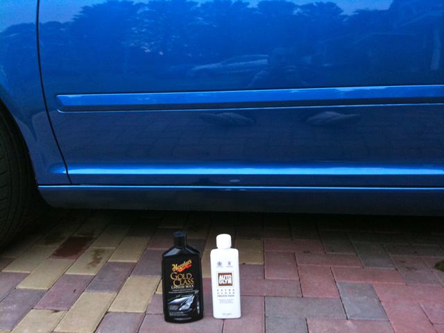

Now it was the turn of MoggyTech inspired AutoGlym EGP topped off with Megs Classic Liquid Wax (again this is on top of Menz FF / Menz finishing pad via DA)
This combo was pretty easy to work with and with 1 less product, slightly faster to apply. Where the Clearkote stuff is applied by DA (and LSP wax by hand) this stuff is all applied by hand. EGP's super easy to use, can't make up my mind about the smell though -- i either want to drink a bottle of it or it's making me high, not sure which, maybe both
The Megs GC liquid wax smells pretty nice. Again dead easy to apply by hand, quick too. This combo definitely wins on speed and smell :thumbup: but could potentially mean getting stomach pumped in hospital if you succumb to EGP's allure

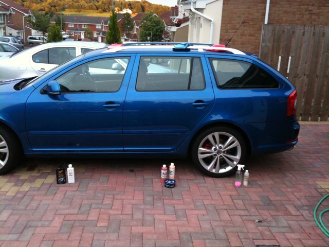

A comparison of my previous best, the Serious Performance stuff vs. Clearkote and that wax that really did nothing for the Clearkote products:

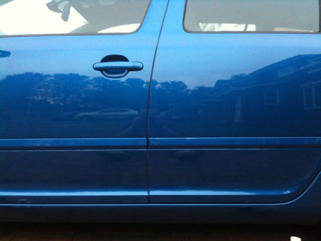

Then Clearkote / Megs #16 vs. EGP / Megs Classic. Even though the Megs #16 really sold this combo short, it's really hard to tell between the 2 in person. I mean if you weren't comparing products side by side, you'd be disappointed with the Megs #16 still but you wouldn't call it a bad finish overall, i mean there's very little in it which is testament to the Clearkote stuff that it still put up a good fight even through a suffocating LSP.
