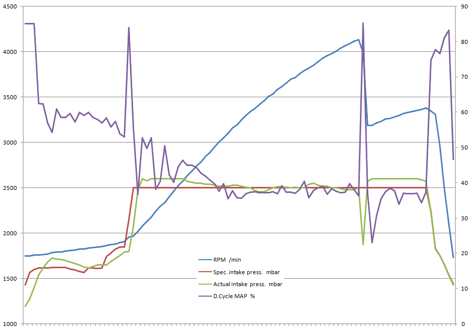

I have exactly the same problems with mine. I had the DPF removed a year ago, so I can take that out of the equation. The car has always had an intermittent habit of hiccuping when putting your foot down after a long time of cruising at a constant speed, usually accelerating out of one of those average speed camera 50 limits on the motorway. Very recently, the problem has gotten much worse and is happening annoyingly often and can happen at any time I'm at full throttle, not just after a long period of steady cruising. As far as I can make out, the only things that could account for the problem suddently getting worse are:
1. N75 valve sticking
2. Sticky vanes
3. ECU adaptation (reflashed the map just over a 1000 miles ago)
With that in mind, I did some VCDS logging of requested boost, delivered boost and N75 duty cycle...
That graph shows me accelerating hard in 3rd and into 4th. Right after I got back on the power after the gear change there was a big stutter. You can see the boost spikes (although the ecu doesn't give values above 2601mbar to VCDS so we can't see how high it actually spiked). The N75 duty cycle looks very strange to me, but I don't have a healthy PD170 graph to compare it to.
Ben and Mikko at Shark Performance were very helpful and put one of their maps on for me temporarily to see if it was just a mapping issue on the Custom Code map. Mikko kept tweaking the N75 tuning, but we couldn't eliminate the problem. This leads me to think that it has to be a hardware issue.
I took the vacuum line off that goes to the VNT actuator from the N75 and tried sucking on it. The VNT road seemed to move smoothly. I also tried doing the N75 test from VCDS which also appeared to move the VNT rod fine.
It's driving me mad. :S

I've ordered an N75 at a cost of £36 inc VAT. Will fit tomorrow. I suspect my £36 outlay will guarantee it's not the N75 at fault and is the MAP sensor or VNT mech or something else, but you've got to start taking things out of the equation somewhere. :rofl:

N75 didn't fix it
