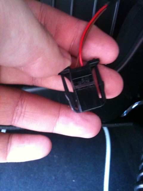

Disconnect the glovebox light connector plug (shortest wire) by squeezing the two lugs either side, see pics below for reference.

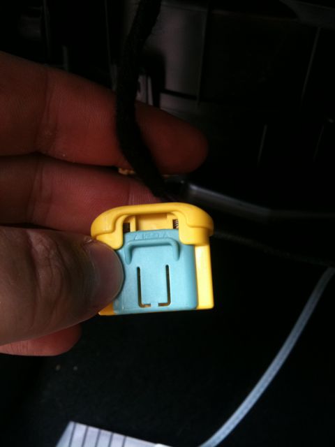

Disconnect the airbag switch connector from its location.

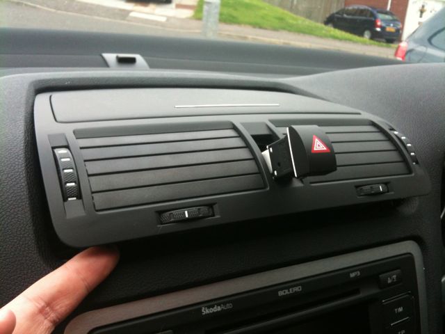

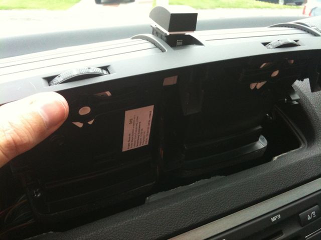

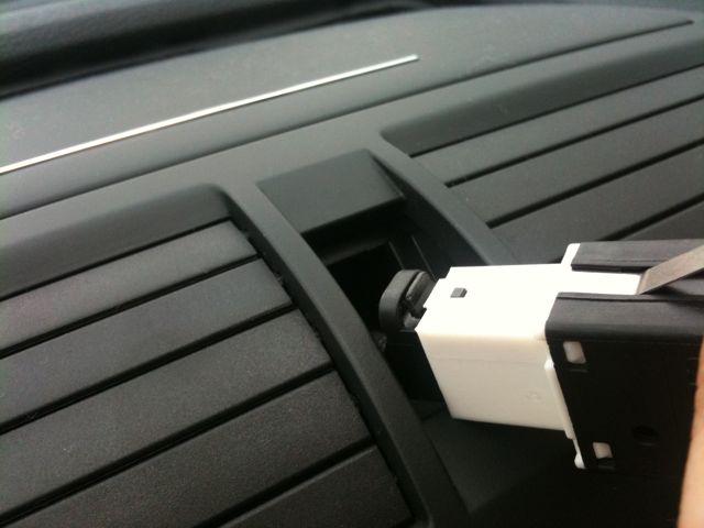

Remove the top air vent unit, there was no need to remove the Bolero in my case because the Factory loom -> Fiscon bluetooth loom joint was accessible from behind the top vent. You can see where the connections are in the pictures below, i use an old credit card type thing for popping this off.
Push the hazard switch fore out of the vent unit, then disconnect the wiring connector from behind to allow you to lift the vent unit away from the dash.

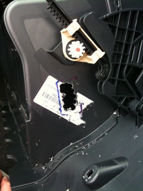

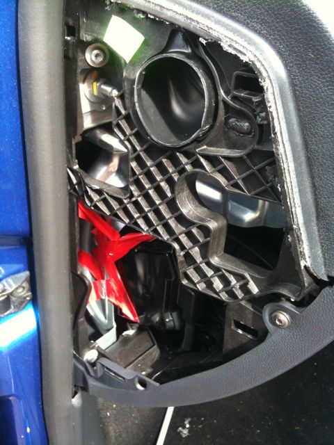

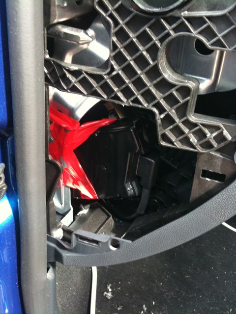

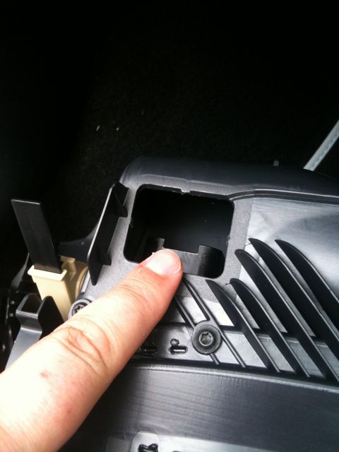

With the glovebox only connected by the (long) A/C pipe, i marked out and cut out the hole for the fly lead trim, here is a pic of mid way progress.
The fly lead trim presses in from the inside of the glovebox, the fly lead then presses into the trim from the outside. Simple, but effective, i like it.
I routed the MDI loom behind the glovebox, well out of the road of the passenger airbag. I then got sloppy and just taped the MDI unit to the dashboard assembly in some free space at the passenger door end. Not sure where the official metal mount should be cited, couldn't be bothered looking up ELSAwin to figure out either so just taped it here...
Then i re-assembled everything, only tricky bit was the airbag switch connector, i had to remove the 2 screws which hold the trim inside the glovebox for the switch, this allowed the switch to come free for easy reconnecting of the connector.

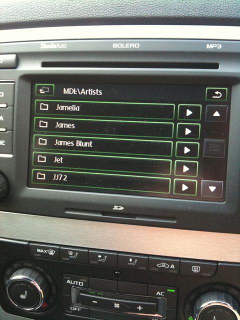

Buttoned it all back up and then it looked like this.
I didn't check how long it took but at a guess i think it was around an hour in total including hoovering up all the plastic shavings :giggle: There's nothing difficult in this procedure and nothing to catch you out.

Hi Dave, just in from work so i nipped out to get a photo, there's not much to see from the glovebox side, i tried to pull the trim out but there's barbs on it hold it securely from the other side of the glovebox. Its raining and i gave in :giggle: I'll be removing it from this car on Saturday anyway in prep for this one being traded in, so will post up a pic.

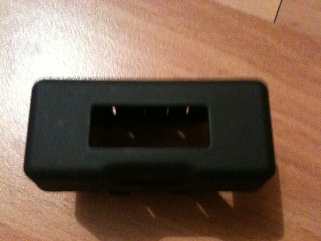

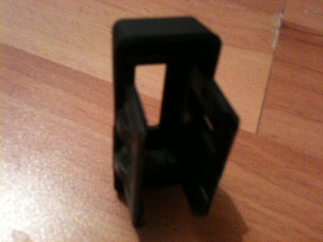

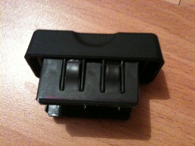

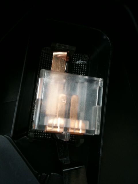

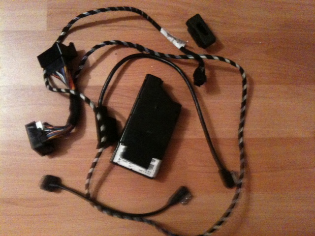

Here's the pictures promised.
Fly lead trim:
Just for completeness, here is the full Skoda kit. Note the VW Golf kit is slightly different in that it does away with the fly lead and fly lead trim, replacing both with trim which houses the mdi box and the whole trim / unit replaces whats inside your armrest.
Apologies for the crap photos. Main PC is stuffed just now and can't be bothered installing stuff to make my camera work on the laptop :)
