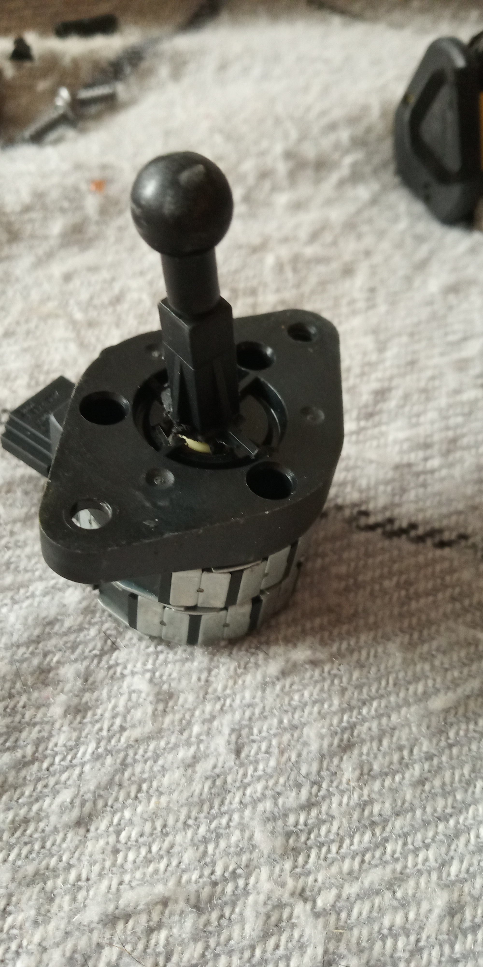

This is how damaged/bend motor looks like.
As you can see on the top picture, the motor have ball on the end of shaft. You need to unsrew the 2 torx and than gently push/rotate the motor down, so the ball with shaft goes up. It have keyhole mount and you need that ball to get out from it.

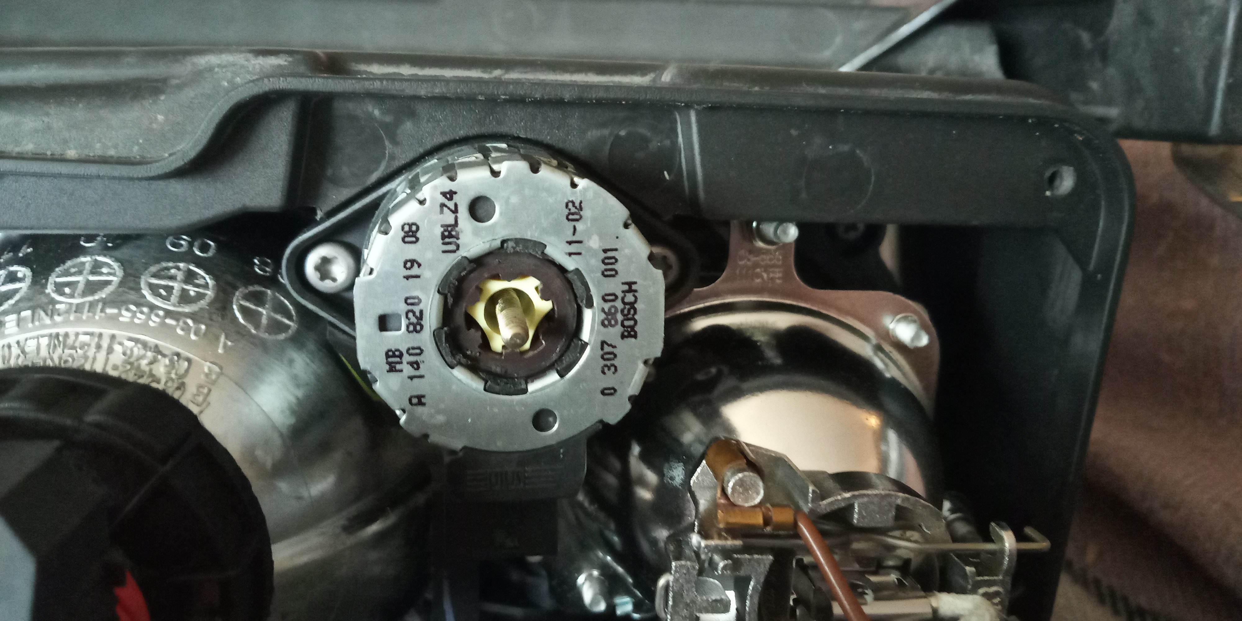

This is a view of installed motor (its damaged, from back, but it doesnt matter for purpose of showing how to uninstall it).
this picture is in same position of the photo, showing the keyhole mount for shaft and way ho to get the motor out. Initial position of the ball on shaft is at bottom of the keyhole.
