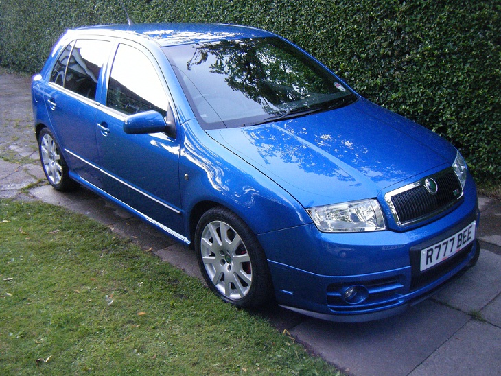

I have used a AP racing coilover set on my VRS and it now sits 50mm lower and looks just right, not too low. but the suspension is fully adjustable.
