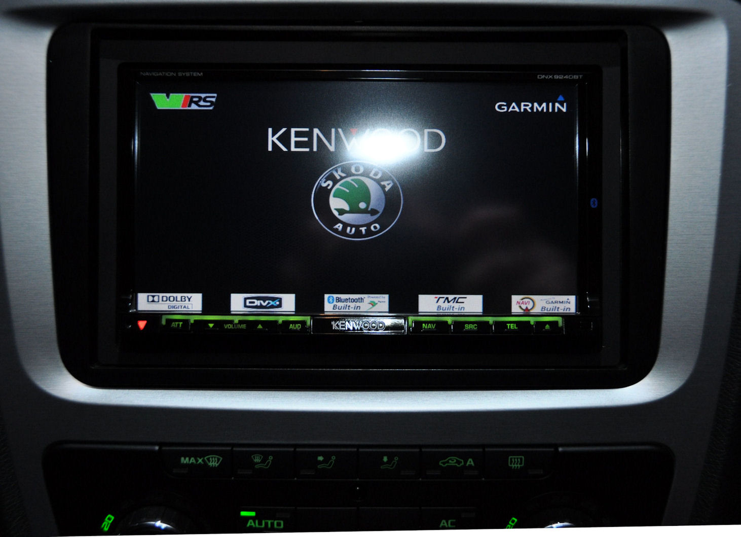

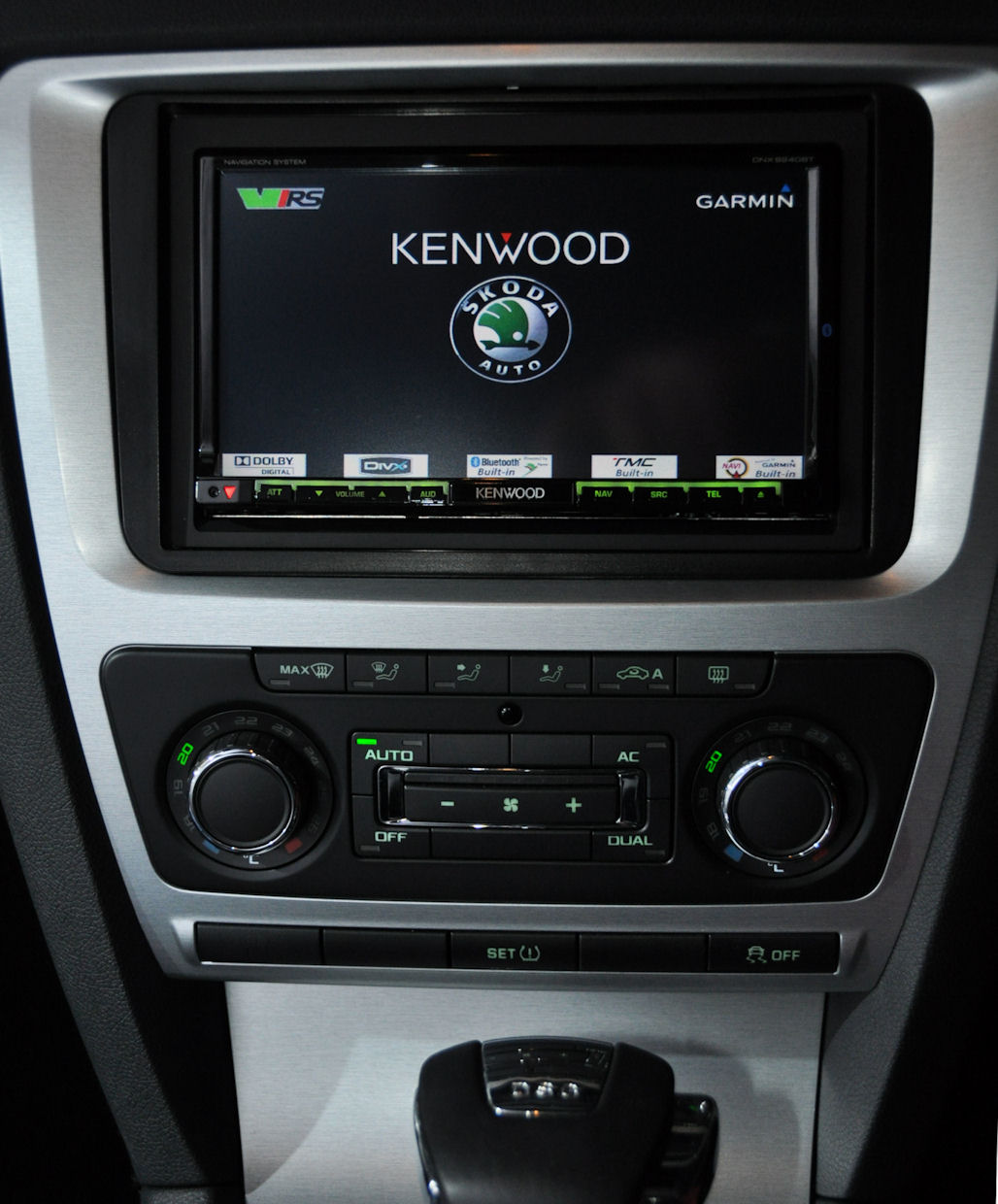

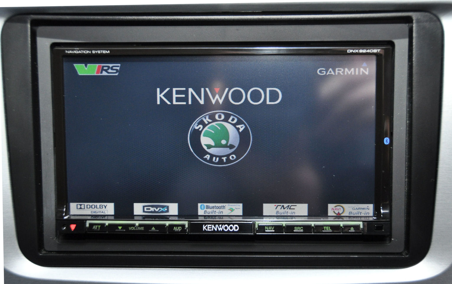

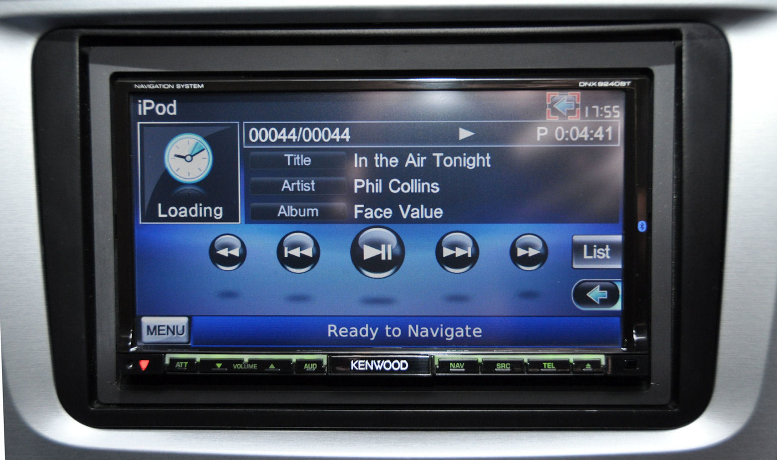

For those that are interested I have updated the post with the finished install pictures.
