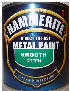

FInally any recommendations for "Skoda green" paint ?

All pretty well covered on here, hammerite smooth green a bob on match. Standard hoses are fine, can use the TT ons which are a touch longer but you need to rotate the car end so it locates properly. Standard hoses are all internally braided.

Hammerite smooth green paint (If you can find any! It was discontinued last year!)
From the People who make Hammerire
The Green (mid) was discontinued as a colour over 3 years ago now I'm afraid, not a popular selling colour at the time.
Ford Modina green is the next best match.
But yes will fit!

Have a look on ebay for some smooth green hammerite! That's where i got mine from :thumbup:
last time i went to order this stuff off ebay it ended up being 'Dark green' and they dont have any normal green in stock...... if you get the right one order 2 ;)

Sorry vRSsunroof, I'd ordered before your post !
Looks the business though, see attached, and there should be 9 tins left.
Woops ! Forgot to thank Mike B for the paint link, Thanks Mike
