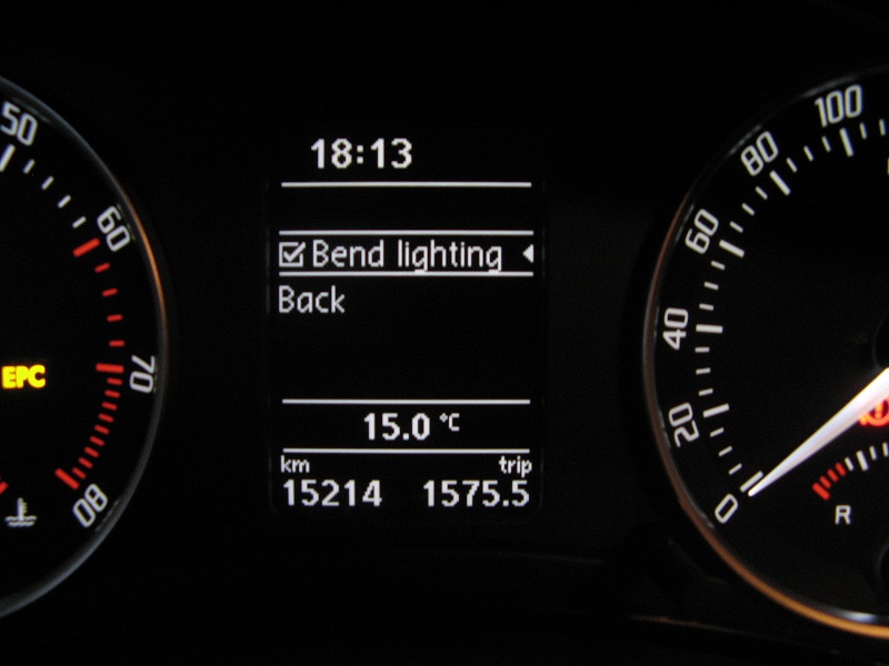

Setup--> Assistant-->Bend lighting
I might be wrong but I think the 'Bend Lighting' relates to the AFS II xenon system, not the fog lamps. I have the Bend Lighting option, but do not have the cornering fogs activated, so I think the fogs are on a separate option.
