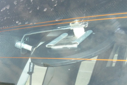

Why not just install a mirror (or two - as I did) at the upper side of the window, on the inner side.
Actually, Friday I finally installed 2 round 3" mirrors. Changes from the posted photos of the test:
Arm(s) made of metal sheet is (are) now "L" shaped thick metal sheet pieces - optional hardware - not used - from an IKEA product.
Connection of mirror to the arm made from domestic metal sheet mirror hardware I managed to change and fit with screw / nut to arms and double sided mounting foam to mirror back. This hardware consist of two pieces - one sliding over the other, so there is a possibility of adjusting distance against the window, aside the angle adjusting around the screw / hinge.
Maybe later I'll post a photo.

I intend to. Meanwhile you can look here: http://www.briskoda....tail-door-trim/
This is a test as said. For your needs, a central mirror (as on my precedent Doblo) may do better. Aside the installation problem, keep in mind that as the central part of the window is smaller and sill is higher than sides, the distance of objects that are beyond the mirror's sight field, is greater than if the mirror is at the side of the window. Furthermore, the cap of the wipper's nozle restricts sight to about 50 cm / 20 inch from the bumper (At floor level. As level rises - distance decreases). You can't see the hook. But I think you can guide the car in the right dirrection, as the cap marks the center / hook. Something like docking an APOLLO to the Lunar CM...

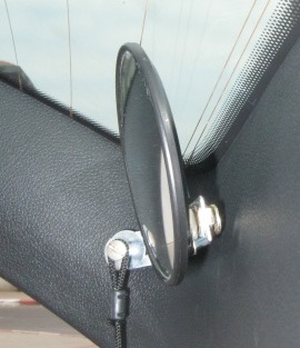

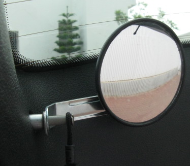

For all of you that waited for the photos, the uploading problem was solved thanks to the site service,
so here is finall fitted mirror on left side. Right side is (obvious and speaking of wich) mirrored assembly of the left one. I used a "floating nut" (I had them in my DIY misc box) at the end of the arm to fit the sliding mirror holder device, but a simple nut and locking washer will also do.
Enjoy and good luck...
