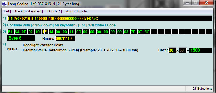

Thanks for the responses. I think I cracked it this morning and it does involve the settings eluded to above, for 'Headlight Washer Activation Time'.
I'll post some more info and a screenshot when I get home, but it's had the desired effect :thumbup:

Here we go - altering the timing within Byte 5 has done the trick. See attached.
It was originally set at 200ms, so no wonder it was coming on straight away! Tried a few settings and settled on 1500ms in the end.
Cheers,
Steve

What does Byte 5 detail, for the washer timings? You should at least be able to wind that back, to reduce screenwash usage on the headlamps.
