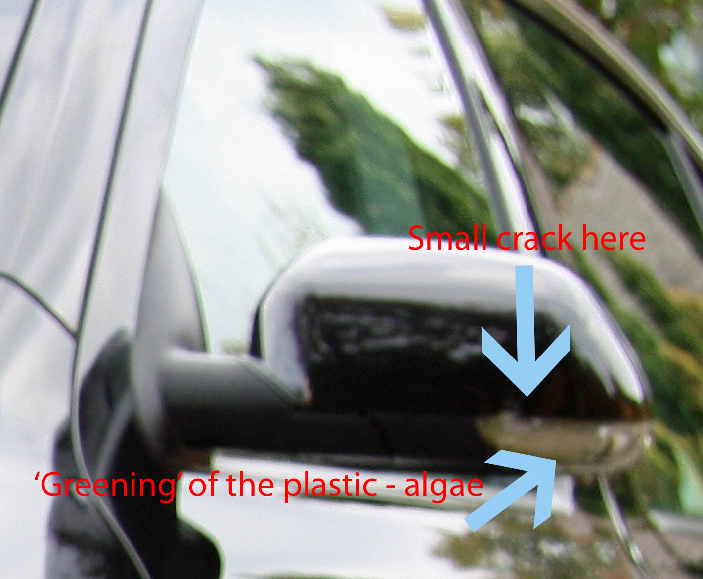

What parts do the mirrors actually come in? I've a crack on the housing of the nearside one, and water has got into the indicator/puddle light section. Everything still functions, but it doesn't look as good as it could!
I know I'll be able to order just the mirror cover on its own, but is effectively the 'white' bit on the underside available separately, or am I looking at a complete new mirror assembly?
Doctored photo now attached, to try and illustrate :yes:

If its only green algy it will almost certainly clean up, toothbrush & hot soapy water & a bit of time should do it.
As to can you buy it seperately I have no idea but Skoda are better than many at selling small parts, If that was on my Nissan I would probably have to buy the whole door :thumbdown:
Yeah, seem to be algae yes. I'll take a close up on the weekend to show, as it seems to have 'worn away' some of the inside detail on the repeater. Difficult to describe without a photo really. Which is why I was considering just replacing it.
I'll have to have a look on ETKA I think, see what's available or whether you need to buy everything together :wonder:
