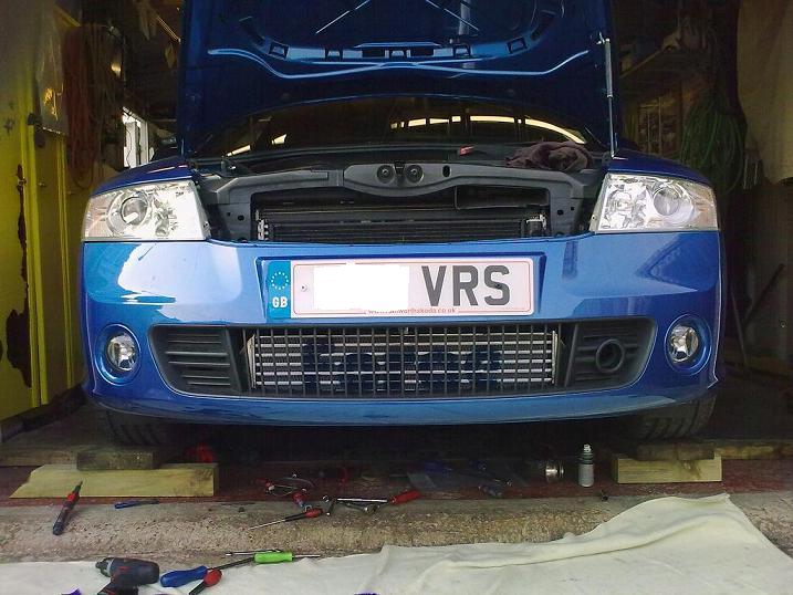

I run a octy vrs with aprox 270bhp, consisting of revo stage 2+, full miltek system inc sports cat, a forge twin cooler, a forge induction kit, a high press fuel pump etc. and it is f*****g awsome, still returns 30+ mpg on a run and shows some of these sports hatches a thing or two!, next will be turbo upgrade to k04 with suitable mapping plus possible internal work. (want to get 380 to 400 bhp next year)
both mine and carls at stage 2+ could keep with a std mk2 focus RS. Both of ours had the full raft of engine/chassis mods though, but either way it shows the potential.

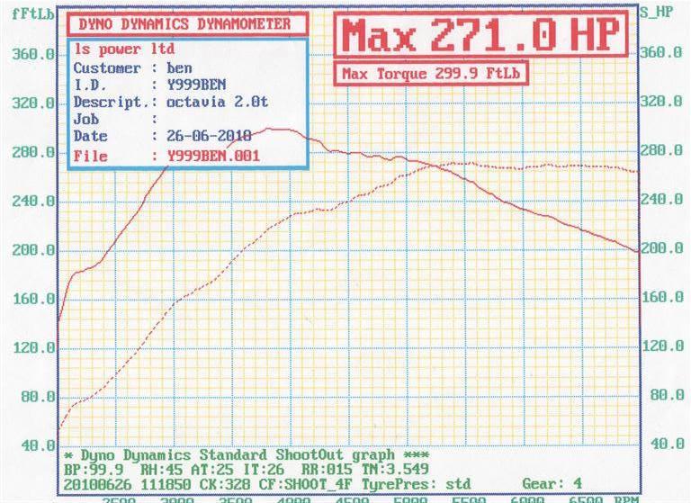

Here's a graph from our car on the rollers at GTI International, on an exceedingly hot day and minimal fans!
Mods are: Neuspeed CAI, full Milltek including sports cat, and Autotech HPFP.
it might only make 271hp peak, but its making that for over 2000rpm. its the delivery that counts and the TFSI engine is fantastic for that.
heres another to reinforce this
