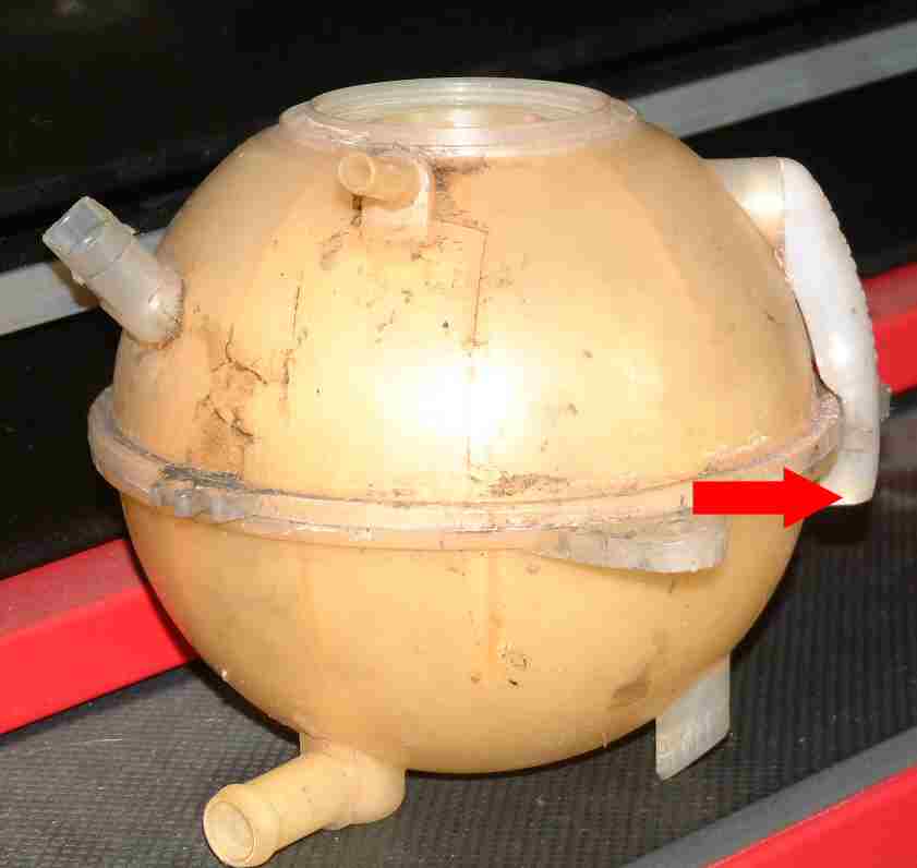

It's difficult to see leaks from the cap, because the cap vents down a pipe (see arrow on pic)
