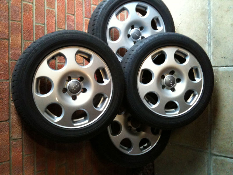

I just bought these as pictures and they are 5x112, offset e42, which on test fit yesterday seemed to fit ok..........................but I'm sure someone else may confirm.

They are Audi 16", 5x112 Et42.
Thanks.
These should be fine.
They are slightly less offset, so will sit more outboard, than your OE rims but then I'd guess they are 6.5J or (the same as OE) 7J so will be fine; there is plenty of clearance.
Of interest I used to run 17" 7.5J ET45 Audi rims and 18" 8J ET45 B14s on my Octavia II totally successfully.

I bought set of these wheels last week, (the ones on the OP link.....
I trial fitted at the weekend and the rears are fine, but the front do stick out a little.... (they are 7J instead of 6.5J)
Don't foresee any problems with clearance or anything, so just need to get winter tyres now !
I think they suit the car pretty well, gives it a poor mans scout look. ;-)
