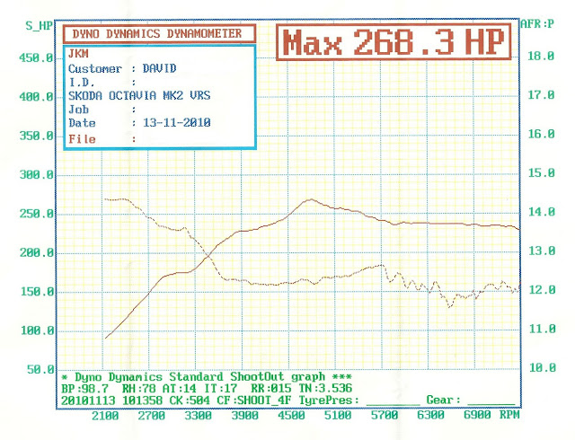

My initial feeling was that it would be the usual coil pack / plug problem. However, a recent Rolling Road day showed some funky AFR/fuelling going on...
Any ideas if something else could be going on here???

The fuel trim is -1.8% and +5.1% which is not bad (although it used be close to zero a few months ago)
The timing retardation was zero to minimal across all four cylinders. I would post up logs but it would just be looking at columns of '0's except when timing pull went to about 2-3 mid-range doing the red line run. (In fact, I would have expected a bit more timing pull as I believe some remappers introduce this to squeeze out a bit more torque).
I did see misfire in cylinder 4 but only occasionally and in 3 very occasionally so I replaced those coilpacks and will test things out again tomorrow.
I do see a couple of curious things - engine load actual drops off vs. expected mid-range revs and the lambda actual vs. requested tracks very closely when accelerating or constant revs (including red line run) but when coming off the throttle at any speed actual lambda goes to 1.99 consistently and constantly whereas specified lamba remains at 0.95 - 1 :wonder:
Does anyone know if that is to be expected?
