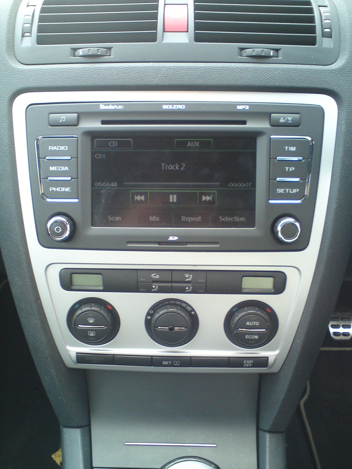

Just fitted a Bolero in my 2007MY Octy vRS, just interested to know people's views on the brightness of the LCD screen? I have mine set to 'brightest' (and running through the settings I can see it is changing from darkest etc) but even in todays inadequate light its quite hard to see unless you look at it head on, is this right, or have I got a faulty screen? Also does the screen darken at night when headlights are put on?

Thanks for the reply, tbh there is no real sun to speak of today just a bit of a glare, below is a picture looking straight at the unit at about 14:15 today:
I know it's difficult to tell with a photo, but that does pretty dim if it's on the brightest setting, sure mine gets brighter than that...

Quick update, spoke to the stealers today who think it is a fault with the HU, then about an hour later they phoned me back after discussing it with colleagues one of which has come across the problem before when retro fitting Bolero or Columbus units into older cars!!!!!!!
Looks like I will be reinstalling the Stream................. :'(
Further update -
Bear with me on this because it confused me when it happened, right, went out to the car yesterday evening to check it started (its been sat in this bl00dy snow for 3 days) which it did! The first thing I noticed was that the Bolero display looked much brighter. Anyway I've had a play and have figured out the following:
If you turn on the HU before starting the car and wait for the 'welcome on board message' to come and go (which is dim by the way).
Then turn on the ignition, at this point the HU turns off, once the car has started, press the on/off switch on the HU, when it comes on the display is bright!!!
further more, I have noticed that if I turn on the headlights the screen will then automatically dim, presumably in to 'night mode'...........................
Could this weirdness suggest a technical fault?
Anwsers on a post card! :thumbup:

And the weirdness continues!!!!!!!!!!! Started the car this morning using the 'new' method, perfect display, tried it 5 minutes later and several times over the last couple of hours, and the 'new' method doesn't work anymore..........I pulling my hair out on this, some help or advice would be very much apprecisted! :S

That is a bit strange. Only thing that springs to mind is the communication between a newer CAN gateway, the Bolero and the rest of the vehicle's electrical systems? As if the communication to the Bolero through the upgraded gateway isn't being interpreted properly and resulting in the wrong level of brightness being set. I've no backing to that logic, just thinking aloud really.
I put one in my MY06 vRS TFSi when I had it and needed to do nothing with the gateway. Will see if I've got an old VCDS log from that and check the gateway revision. I never noticed any issue with the screen brightness at all. Initial reactions to your symptoms I'd say a faulty backlight on the unit, but then your discoveries with alternative starting and fiddling about perhaps make me think otherwise...

I've tested the unit in another car and its fine, so it must be an issue with my gateway/electrics, anyway I'm fed up with the hassle and the fact that function wise it does know more than my Stream, no climatronic display etc, so it's on ebay now!

Just as a bit of general info
I know this thread is old(ish) but this is how my bolero looks set at medium light
MY2011 vrs octy

Not old - useful info :thumbup:
Hopefully this can be used by people as a resource in the future, to save re-inventing the wheel. IF they can find the thread again of course ;)
Only issue I can see of people posting up photos of their units on different levels of brightness, is the time of day and camera/camera settings used. We unfortunately won't get a uniform picture of things.
Cheers,
Steve
Nikon D60
Middle of day
