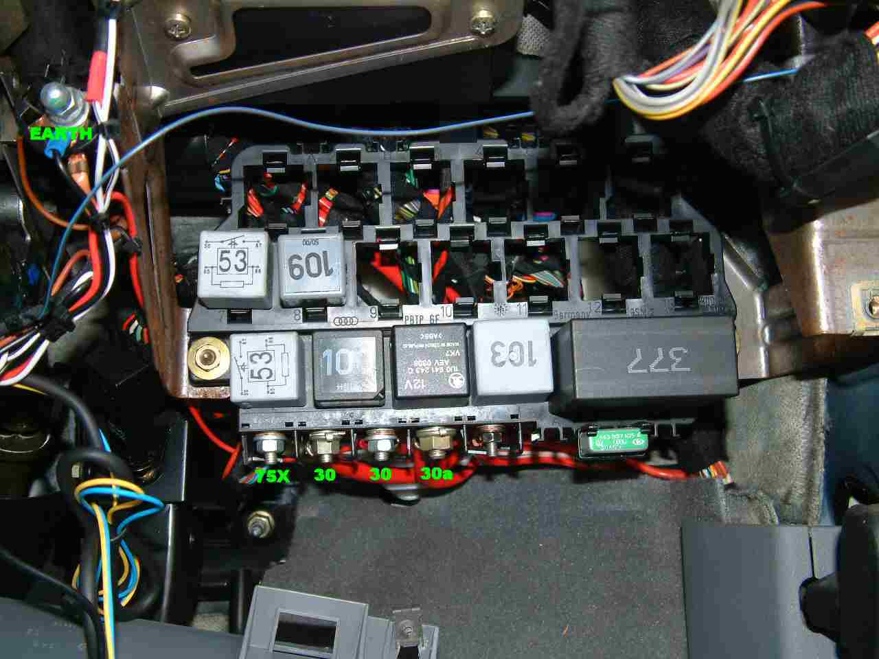

yes under the steering column the undertray there has a earth ring and a posiitive feed iirc, thats where mine are wired to.
Hi Oet,
That is really useful, where abouts are they? could you describe a bit more?
Cheers
Ron
This should help
This should help
You Legend! thanks :)
