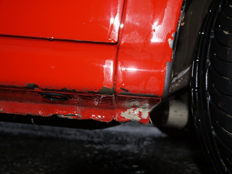

Here's a photo of the damaged area... looks worse than I remember. Thinking I might have to properly take the paint off and do it (or is it a bodyshop job?)
I don't think that mudflaps will cover that up................ :S
The idea of the mudflaps would be to prevent it happening again after I fix it :)
Of course........... :thumbup:
Maybe a smart repair but the area needs to be sand back and treat and primed and painted. The rust creeps under the paint so the area that needs painting is much larger.

What I have ended up doing as a temporary solution is:
I sanded back the areas a little with some sandpaper, to expose clean metal and to roughen up the paint to get my new paint to stick
I heated the area with a hairdryer to make sure that all moisture from the area had gone
I applied about 4 or 5 layers of official skoda touch up pen paint, heating each layer with a hairdryer and allowing to cool inbetween
I finger-applied a thick layer of clear waxoil over the top of this to provide a watertight seal and to protect the paint while it cures properly (I didn't bother with lacquer because it was 1degree c outside and the lacquer would have cracked when cooling I think)
I bodged up some temporary mudflaps to keep mud and stones off this exposed area while I wait for some official skoda front mudflaps to arrive (about £12 or so)
In the summer, if I have some spare time, I will properly clean up the area again, put another layer of touch up pen on it, followed by some stoneguard, and then will put some paint over the top of that stoneguard. I will then probably polish the bottom of the car to try to get the paints to blend, though this shouldn't require too much jiggerypokery as 90% of this affected area is on the underside rather than the side of the car.
For the moment, am happy with a repair that has basically cost me a touch up kit and a couple or three hours of my time.
You have no primer there which is the key really. Id recommend zinc182 primer for bare metal.
I'll probably in which case sand it back to the bare metal and put proper primer on, come warmer and drier weather :)
