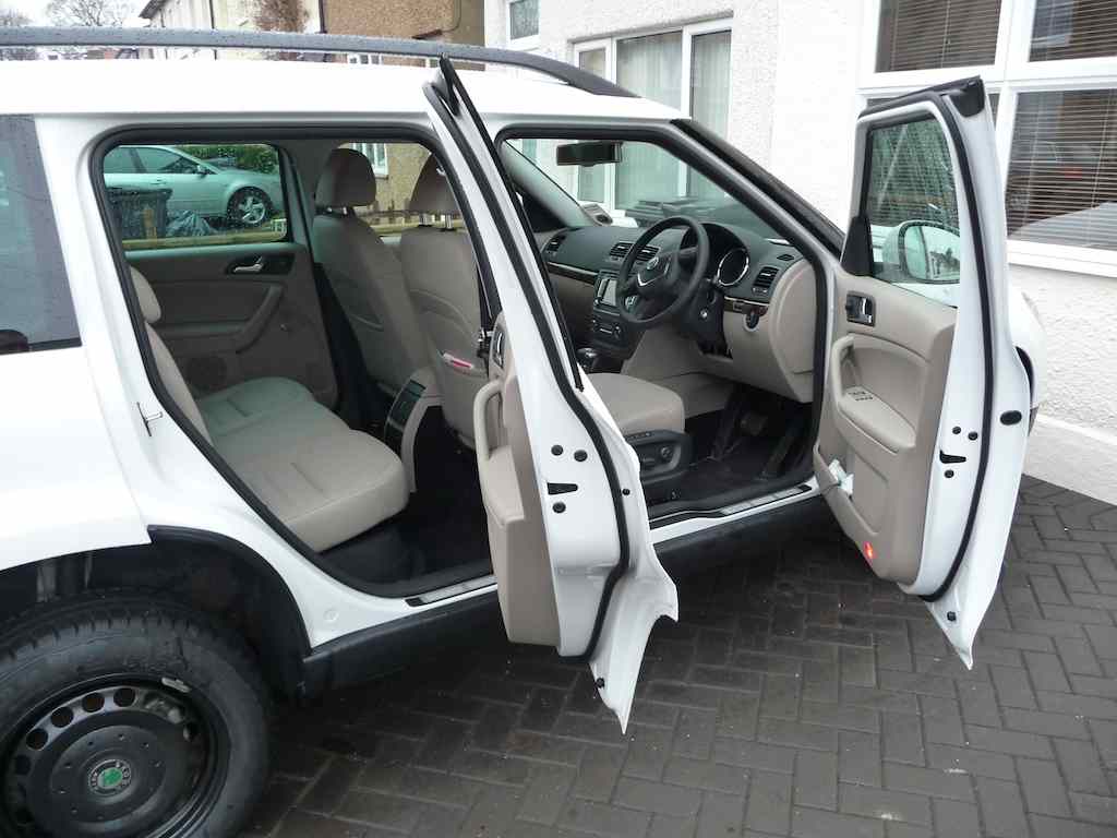

By the way, here is a Candy White Gobi photo just for you....
and yes, a heated steering wheel would be the icing on the snow.emoticon-0136-giggle.gif
