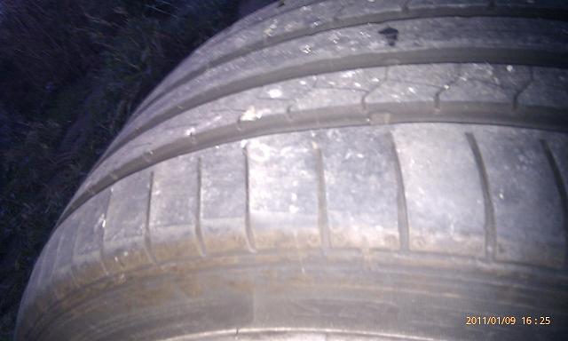

FWIW, mine do not really show any signs of excess wear but if you run your hand over it you can feel the "sawtoothing"
as you can se in the pic the outter and inner markers are equal, since swapping over the rears to the front the noise has gone.
