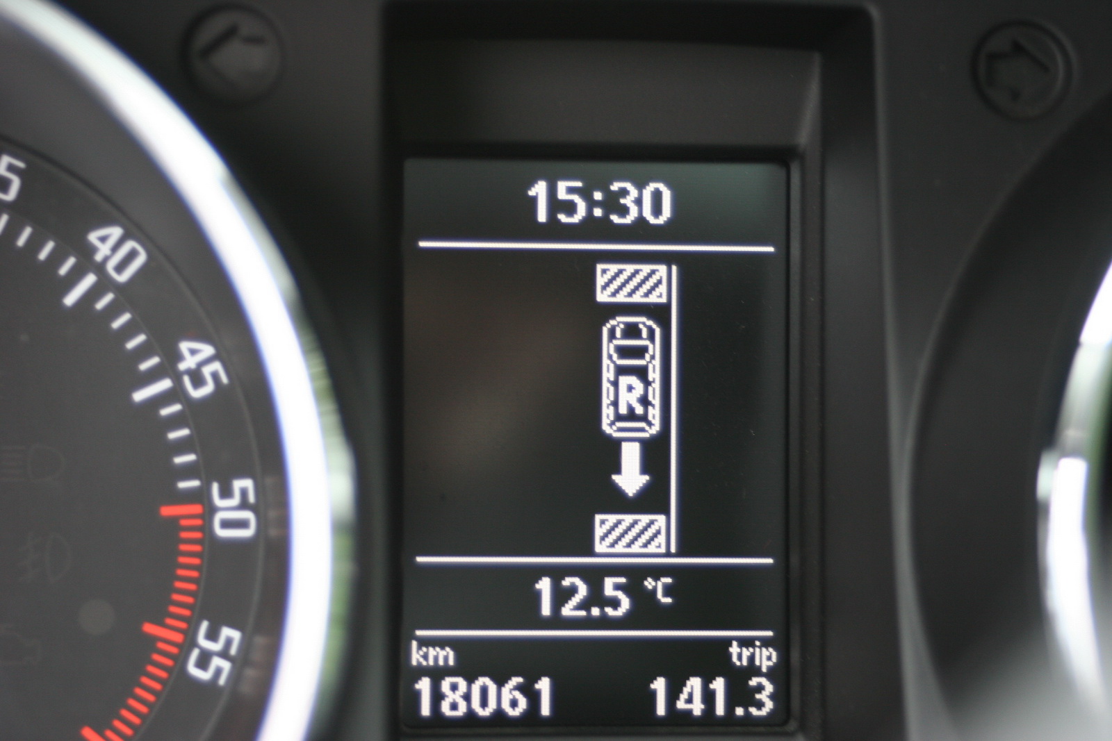

If you don't use the indicator it will automatically search to the left (of a UK car) displaying the cars you drive by as a hatch area.
If you then use your indicators to indicate right, the hatched area in the Maxidot display swaps from the left of the car pictogram to the right so you can clearly see which side the car is searching for a parking space.
