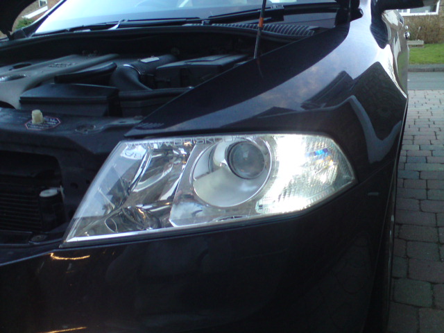

Eric can you take a look at the pic please, to me the LEDS seem quite blue. Is everyone elses this colour?
Its difficult to say by looking at the picture (due to camera and monitor colour response etc.). However all of the ones that I've sent out should be a good match to 4100-5000K HIDs and look 'white' against those bulbs. They might look a bit blue against halogen headlights (which are slightly yellow).
The bottom line is that if you are not happy with the colour then PM me and you can return them for refund, or I can send you a new set which I'll double-check for 'whiteness' before I send out.

Looking at ccs-digital's post http://briskoda.net/forums/topic/184915-new-hids-and-led-sidelights-fitted/page__st__20 his seem a little blue too but tbh mine only really look blue when HID lights are on, then the difference is quite noticeable. I will take another pic tonight with just side lights on.
Probably better to send them back and I will take a look at them. They should not look blue against HIDs (assuming HIDs are 4100-5000K). With the LED removed from the sidelight unit and powered from 12V (e.g. via a mains adapter or from the car battery) they should a nice bright 'toothpaste' white. Taking pictures with a camera can be a bit hit-and-miss because the camera responds differently to the human eye, and of course people's monitors tend to behave a bit differently.
I would say theres a fault with those, definately not the same as mine -

Not sure what to say now. Here are some more phone pics
When the side lights are only on they look nice and White
But when main beam is on they look blue
